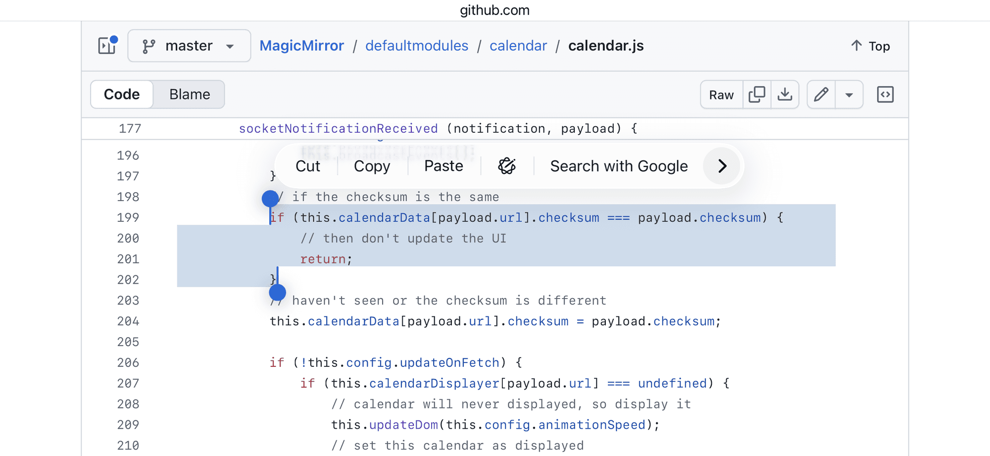

]]></description><link>https://forum.magicmirror.builders/topic/20250/calendar-events-broadcasting-nothing-showing...</link><generator>RSS for Node</generator><lastBuildDate>Wed, 27 May 2026 19:44:56 GMT</lastBuildDate><atom:link href="https://forum.magicmirror.builders/topic/20250.rss" rel="self" type="application/rss+xml"/><pubDate>Wed, 27 May 2026 15:50:59 GMT</pubDate><ttl>60</ttl><item><title><![CDATA[Reply to Calendar events broadcasting, nothing showing... on Wed, 27 May 2026 18:15:40 GMT]]></title><description><![CDATA[<p dir="auto"><a class="plugin-mentions-user plugin-mentions-a" href="/user/bkeyport" aria-label="Profile: BKeyport">@<bdi>BKeyport</bdi></a> broadcasting is different than using</p>
<p dir="auto">Can you explain the setup and config you are running.</p>
<p dir="auto">Is this multiple systems to one server?</p>
<p dir="auto">We added a caching handler to reduce unnecessary sends to the same module</p>
