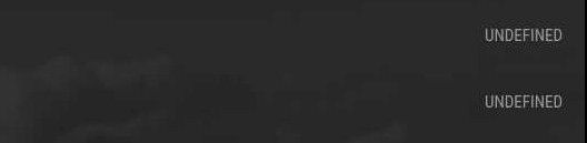

<p dir="auto">Weirdly my the MMM-PublicTransportHafas has also failed to work under 2.38.<br />
It just shows up as “UNDEFINED” and no logfile entry.</p>

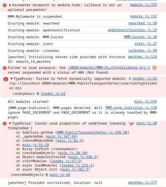

<pre><code>[2026-10-01 21:32:56.041] [WARN]  [apis] MMM-Fuel: Filtered stationIds list is empty
[2026-10-01 21:40:10.987] [WARN]  [apis] MMM-Fuel: Filtered stationIds list is empty
/home/pi/MagicMirror/node_modules/electron/dist/electron exited with signal SIGINT
[2026-10-01 21:43:21.195] [WARN]  [apis] MMM-Fuel: Filtered stationIds list is empty
</code></pre>

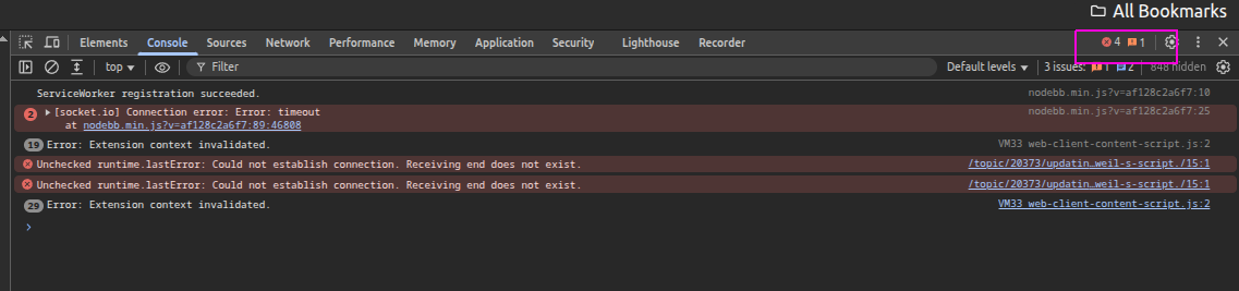

<p dir="auto">but the wallpaper error is in the node_helper…</p>
<p dir="auto">can you open the developers console</p>
<p dir="auto">ctrl-shift-i (lower case letter eye)<br />
select the console tab<br />
and look around for any errors, top right would be a number of those as well (pink box)<br />
<img src="/assets/uploads/files/1790882348713-screenshot-at-2026-10-01-14-18-05.png" alt="Screenshot at 2026-10-01 14-18-05.png" class=" img-fluid img-markdown" width="1137" height="267" /></p>
