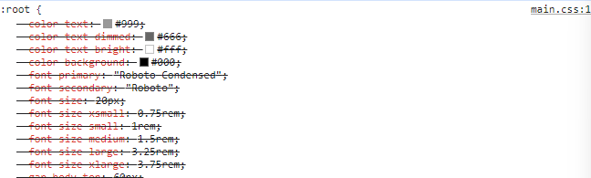

              In particular, most of the key defaults are in :root. You can override that in your custom.css
              The default apps, and many well behaved other modules will use these defaults in some form.

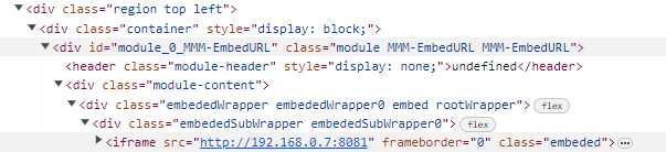

                    The Elements Tab shows the raw HTML generated by MM. If you click on the icon in the upper left of the elements window as shown below, you can then click on an item you want to change and see how it’s done.
                    Chrome: 043fc2cd-0dca-46e3-a333-2fed25b75137-image.png Edge: 5533d5b8-b937-4b1d-93f6-4212a3a1c9c3-image.png
                    you’ll see something like: 017d17e9-7c9a-4c80-b79c-d3bb686c0cd1-image.png
                    You can then either use those to find the classes in their respective css files (In my case MMM-EmbedURL.css in the MMM-EmbedURL directory, or main.css in the css directory, and adjust in custom.css if you don’t mind reloading frequently to see what happens.

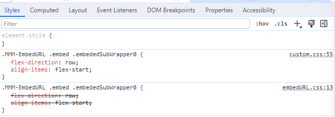

                    Alternatively, there’s a Styles tab, usually located below the elements tab, that you can pull up, and follow Sam’s direction. Generally, the options flow from top to bottom in this screen, and crossed out items are overridden (even with the same items) with something above it - it’ll show what and where it got it, by line number too.
                    Variables are declared like var(–aVariable) – if you see that, the setting is elsewhere, go lower in the styles, you’ll find it without the var() wrapper, that’s the declaration. Again, the location of the original CSS is listed in the upper right hand corner for you to grab and modify.
                    (my root declarations are in custom.css starting at line 12)
                    (Their root declarations are in main.css starting at line 1)

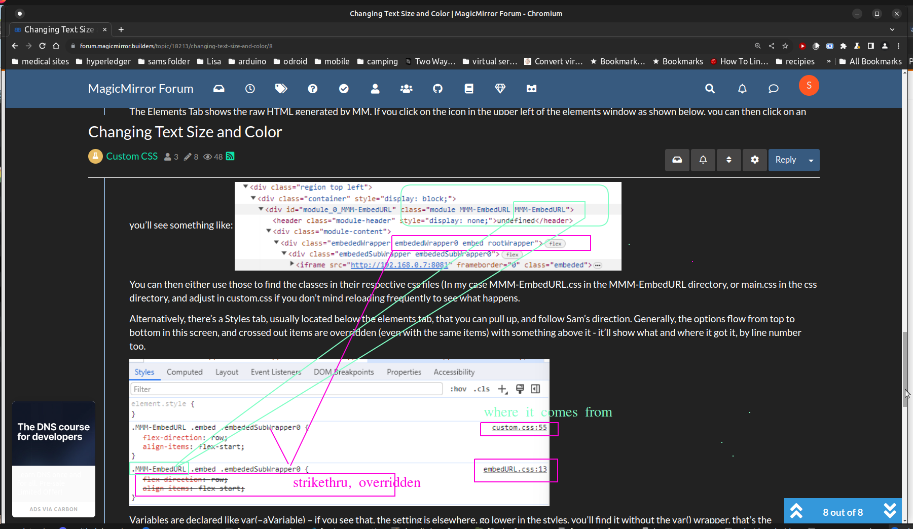

                      and here is those views tied together. the class module… MMM-EmbedURL
                      to the start of the css selector clause
                      . (means class)MMM-EmbedURL
                      the original in EmbedURL.css
                      which is overridden (because of the strike thrus
                      and the overriding will be higher up in the right pane as the higher will override the lower… its a stack… top-most wins
                      this css entry applies to elements that have the (selector of)
                      module classname
                      .MMM-EmbedURL
                      AND the .embed class
                      AND the .embededSubWrapper0 class
                      (because there is space between them neans nested is supported
                      if there was NO space, it would me an element that has ALL these attributes(classes in this case) AT THE SAME TIME.
