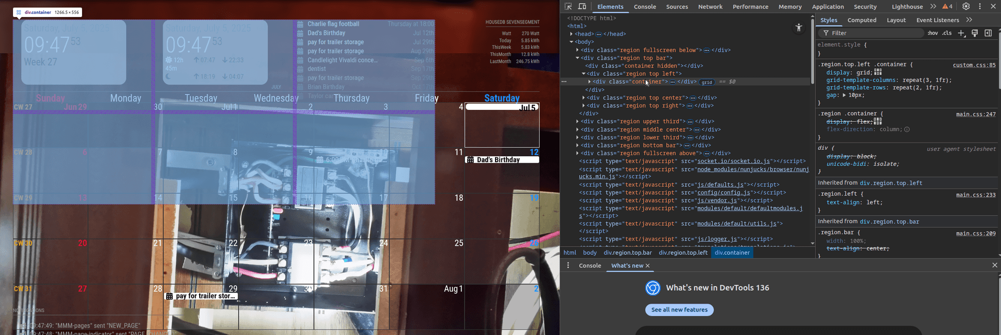

              Here is the content of the container from dev-window:
              <div class="container"><div id="module_0_MMM-RTSPtoWeb" class="module MMM-RTSPtoWeb MMM-RTSPtoWeb" style="order: 0;"><header class="module-header" style="display: none;">undefined</header><div class="module-content"><video class="rtw-video" autoplay="" playsinline="" style="max-width: 100%;"></video></div></div><div id="module_1_MMM-RTSPtoWeb" class="module MMM-RTSPtoWeb MMM-RTSPtoWeb" style="order: 0;"><header class="module-header" style="display: none;">undefined</header><div class="module-content"><video class="rtw-video" autoplay="" playsinline="" style="max-width: 100%;"></video></div></div><div id="module_2_MMM-RTSPtoWeb" class="module MMM-RTSPtoWeb MMM-RTSPtoWeb" style="order: 0;"><header class="module-header" style="display: block;">Nordseite</header><div class="module-content"><video class="rtw-video" autoplay="" playsinline="" style="max-width: 100%;"></video></div></div><div id="module_3_MMM-RTSPtoWeb" class="module MMM-RTSPtoWeb MMM-RTSPtoWeb" style="order: 0;"><header class="module-header" style="display: block;">Terrasse</header><div class="module-content"><video class="rtw-video" autoplay="" playsinline="" style="max-width: 100%;"></video></div></div><div id="module_4_MMM-RTSPtoWeb" class="module MMM-RTSPtoWeb MMM-RTSPtoWeb" style="order: 0;"><header class="module-header" style="display: block;">Garten</header><div class="module-content"><video class="rtw-video" autoplay="" playsinline="" style="max-width: 100%;"></video></div></div><div id="module_5_MMM-RTSPtoWeb" class="module MMM-RTSPtoWeb MMM-RTSPtoWeb" style="order: 0;"><header class="module-header" style="display: block;">Südseite</header><div class="module-content"><video class="rtw-video" autoplay="" playsinline="" style="max-width: 100%;"></video></div></div></div>

                so you have 6 instances of module, which will be stacked vertically by default.
                I see some change was made to container, now in main.css where is wasn’t before…
                I think this is a side effect to the “order” config option…
                I don’t know how to fix it at the moment… I am busy most of the day

                    just to let you know, I got it, now I copied the old main.css over the recent one and it’s working as before.
                    Diff says:
                    242,254d241
                    <  * Container Definitions.
                    < .region .container {
                    <   display: flex;
                    <   flex-direction: column;
                    < .region .container.hidden {
                    <   display: none;
                    so, this is a bug then?
                      sdetweil @falter
                      @falter not you
                      if you look in main.css
                      container is defined
                      it was not in prior release
                      so i think it defaulted to
                      display:block;
                      now its defined as
                      display:flex;
                      flex-direction:column;
