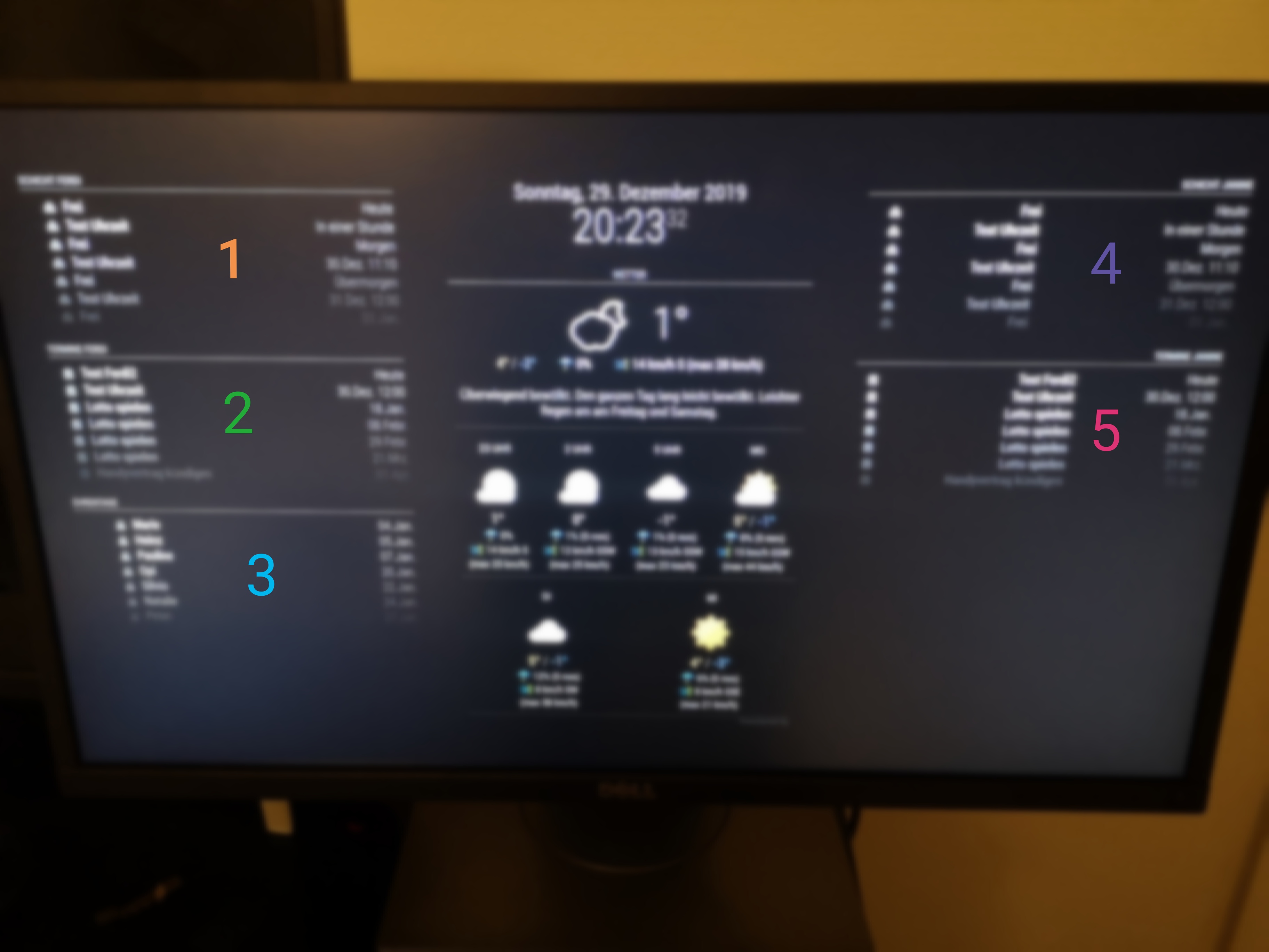

      Hey guys.
      Today I experimented a little with the standard calendar for a simple overview. So far I am satisfied. However, the text alignment bothers me a bit, as you can see in the picture. Is it possible to adjust this via the css?!
      Calendar 1 and 2 looks good
      The eventtitel and Symbol from calendar 3 is to much right
      Eventtitel From 4 and 5 ist right alignment, but would Look better if its left
        sdetweil @Clubjack
        @Clubjack so, how did you do 5 calendars?
        affects how to fix them
        left edge of 2 looks too far left compared to 1
        show the config.js

            sdetweil @Clubjack
            @Clubjack said in Standard calendar Determine text alignment:
            and the other positions?
            top_right?
            do you have any custom.css entries?

              Oh yes.
              Calendar 4 an 5 are with the same settings, only Position is top_right.
              I have an entry in custom.css, but without the entry it is the same alignment.

                sdetweil @Clubjack
                @Clubjack right, .module-content doesn’t mean anything
                U are lucky most modules don’t support multiple instances like that.
                My ‘guess’ is that there is some padding wrap in front of the tables for the calendar.
                I would use the developers window, elements tab, to explore the css tree for each.
                Note that because they are the same module name, one css entry will affect all of them

                    Clubjack @sdetweil
                    Hey…
                    I tried something.
                    If one of the displayed event titles (calendar 3) gets longer, then the alignment fits.
                    This means that the calendar symbol and the event title align together.
                    It would be better if the calendar symbol were always aligned to the left and the event title follows it.

                        Clubjack @sdetweil
                        Hey…
                        In the meantime I managed to align everything. Via the custom.css.
