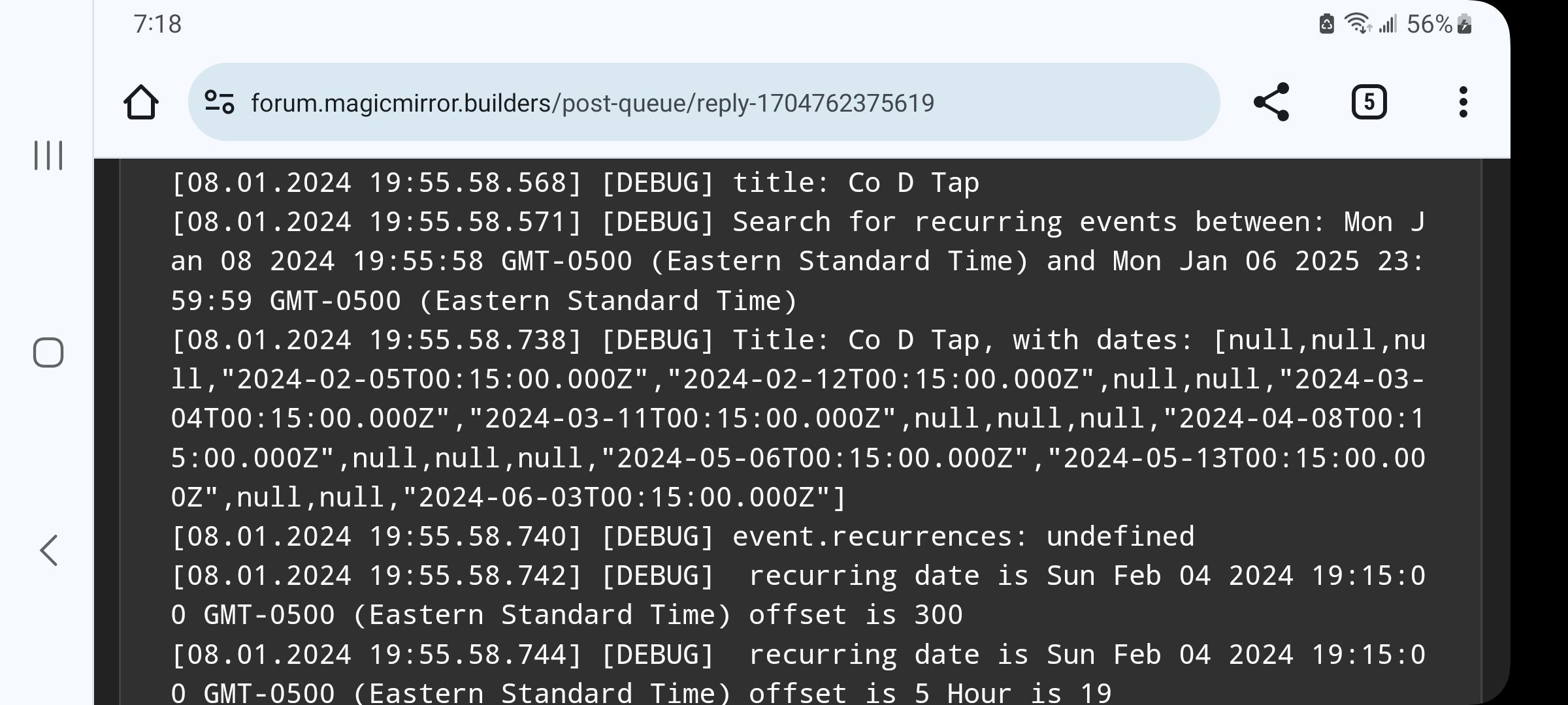

        sdetweil @songman
        @songman the rrule library is having trouble.
        add
        “DEBUG”
        to the logLevel list at the top of config js
        then use (pm2 stop all ahead of this)
        cd ~/MagicMirror
        npm start >somefile.txt 2>&1
        you’ll see Processing Event
        and dates: [… ] for the list of recurring dates
          @songman yeh post was marked as spam
          but there is is null, null
            songman @sdetweil
            @sdetweil so the nulls are expected to be dates, is this a google problem or an rrule issue?
              sdetweil @songman
              @songman that is an rrule problem. the ICS parser we use, node-ical, has included a new rrule version which supports utc based times, where the prior didn’t.
              clearly it has some troubles.
