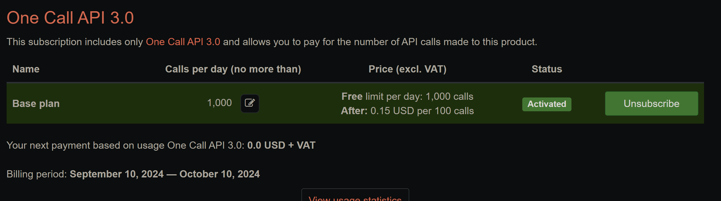

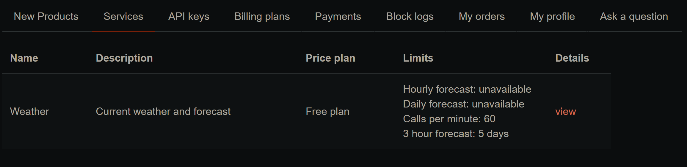

                    sdetweil @Socrates
                    @Socrates i believe the 3.0 free tier also requires a credit card on file…
                    they give you 1000 calls no charge per day, but if you go over they charge you
                    see the link ‘Pay as you call’
                    (vs prevent the api from working)
                    this is new for 3.0
                    the linked pages says
                    'One Call API 3.0 is included to the “One call by call” subscription plan only, users pay for the actual use of the product. '
