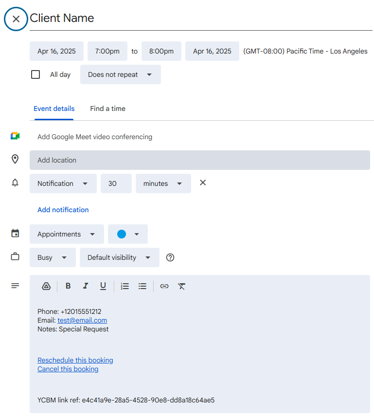

            • BKeyportB Offline
              BKeyport Module Developer @sdetweil
              @sdetweil What I meant is to replace the Client’s name with “Client” - it’s a wildcard.
              The “YCBM” is in the event description to help my booking manager (YouCanBook.ME) to track the bookings for me.
                sdetweil @BKeyport
                @BKeyport ok, what does ‘clients name’ look like
                any examples?
                • BKeyportB Offline

                  Web links removed, Test client deleted, so no clicky. The event title is solely the client name, but that can be adjusted if need be, I think.
