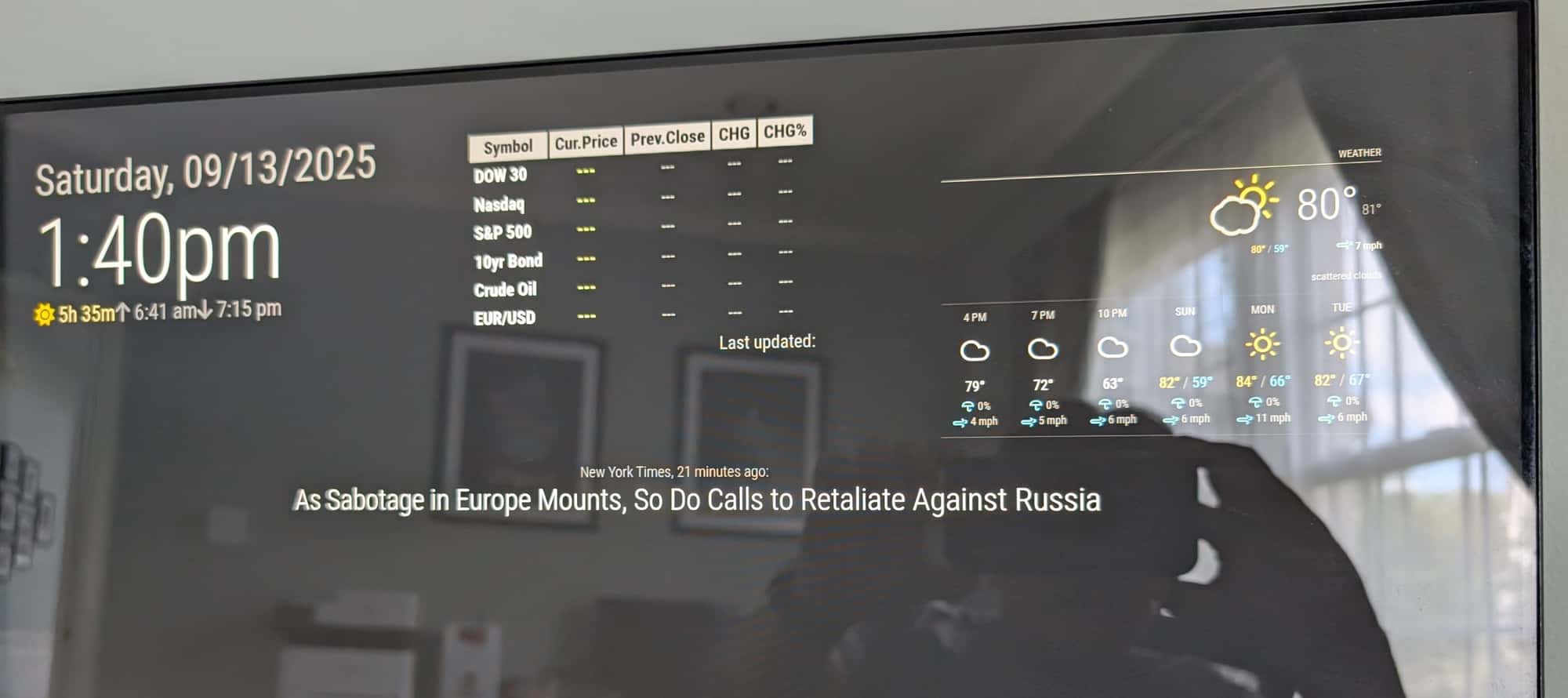

      I have been setting general module position using a preset module location such as position: “top_left” in my config.js file and then resizing/minor adjustments in custom.css file via module specific transform (size) and position: relative with px adjustments of one or more sides. This process has worked just fine with the default clock and MMM-MktIndex perfectly.
      However, now with MMM-OpenWeatherMapForcast module, it does not matter what changes I make in custom.css, that module will not move it’s position. I have tried both relative position changes and absolute position changes but it stays in the same location. Interestingly, in the same custom.css bracket for that particular module, the transform (0.75) has worked to make the module smaller, but the position changes do not take effect. Sometimes on launch, I will see the entire briefly in a different position, but it appears to snap back to the same location. I thought that settings in custom.css were highest in the hierarchy, so not sure why I cannot change the position.

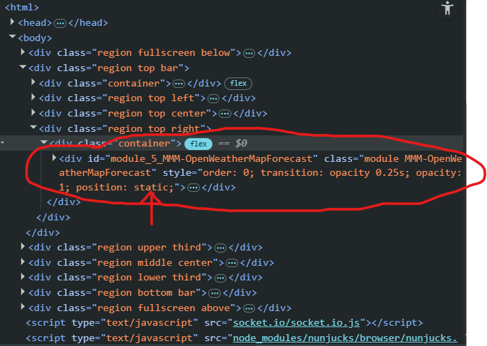

                          Okay, I was finally able to access my MM from another computer where the dev window was not painfully slow. I think I have found the attribute that is making the module immovable, but I have been unsuccessful in correctly adding a line in custom.css that will change that position attribute from the picture from “static” to “relative”.
                            sdetweil @brgracer
                            @brgracer
                            try
                            .module.MMM-OpenWeatherForecast {
                                 position:relative !important;
                            because the setting is made on a more specific statement you need !important to force override
                            • B Offline
                              brgracer @sdetweil
                              @sdetweil Finally worked! Thank you yet again!
