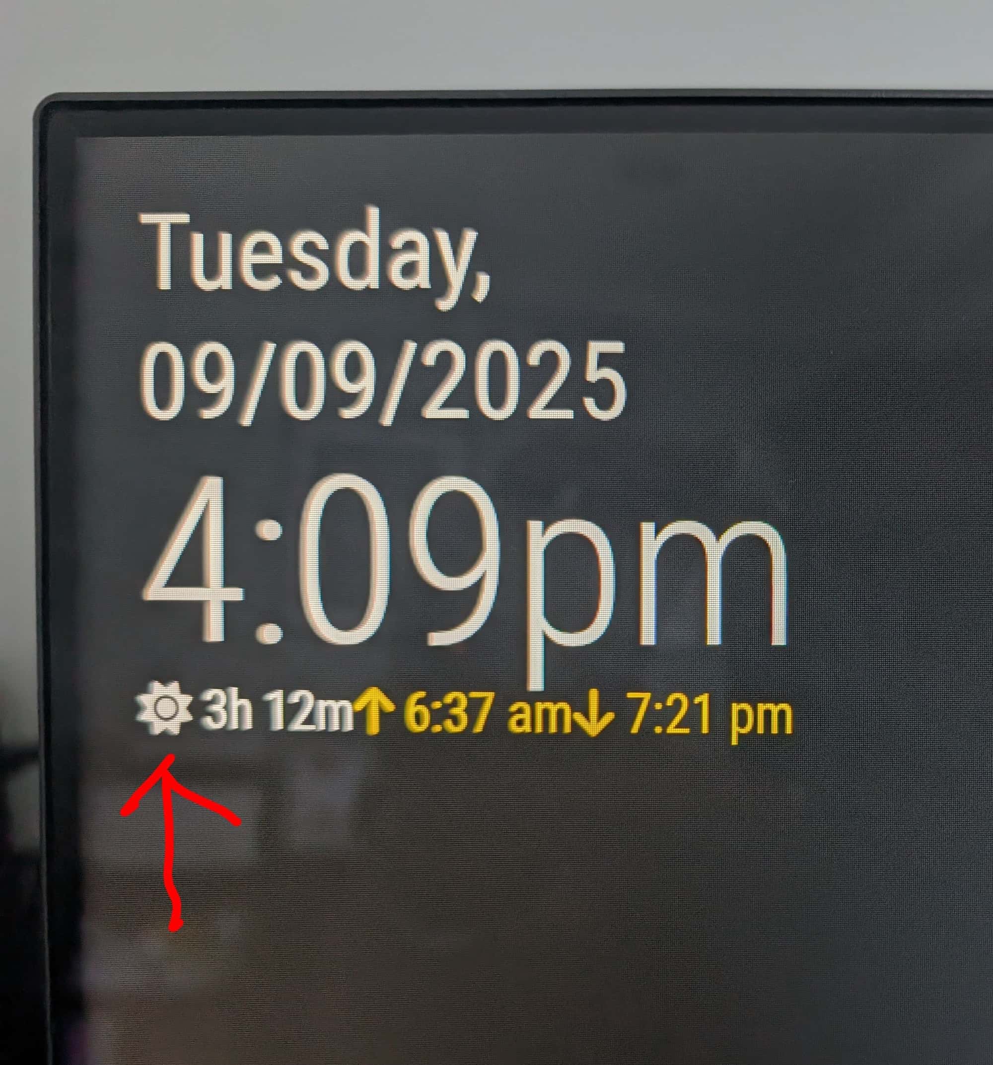

    • Default Clock SunTimes icon - color change?
      For the default clock module, I am able to change the color and format of date and time. I was also able to change the color of the sunrise/sunset times, but I cannot figure out how to change the color of the sun icon (see screenshot) and the daylight left time next to it. Any assistance is greatly appreciated.

    • RE: Default Clock SunTimes icon - color change?
      @sdetweil That worked and thank you.
      Separately, your older posts have been super helpful in tracking down other issues, so thank you for all those prior answers as well. Several of your older posts/answers have helped me so much in tracking down issues that were driving me nuts. You are a treasure to the community!
