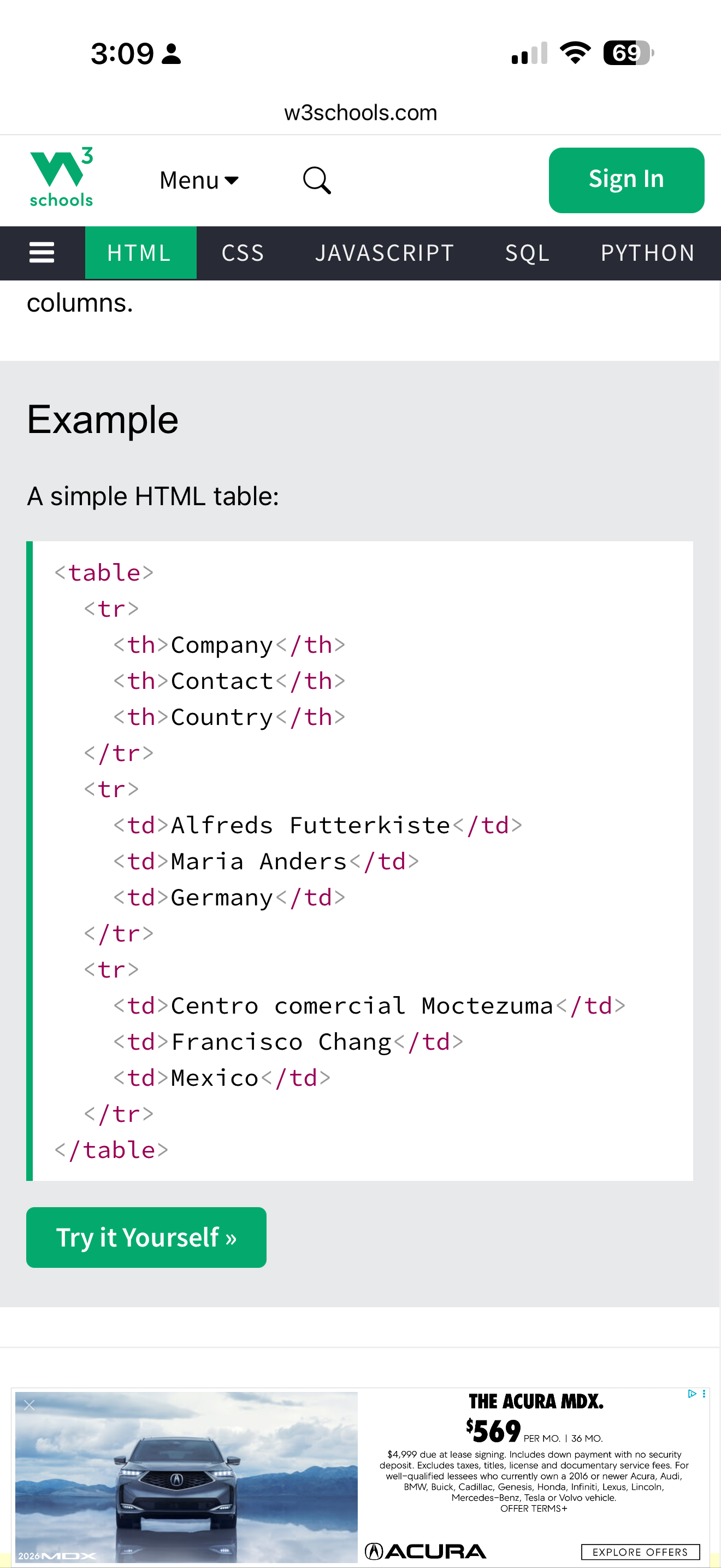

        @Cybex999 this module uses the templating system nunjucks
        If you Look at the njk you can see it builds a vertical table
        You could rewrite part of the njk to use th to define columns
