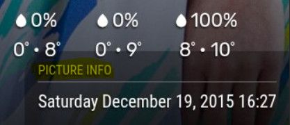

      Using MMM-BackgroundSlideshow for a while now and trying to tweak the imageInfo box to remove the header.
      Current header: PICTURE INFO
      I’d like to remove it entirely.
      My module config is below:

      			**imageInfoTitle: "Photo Details",	//fails to change header**

        rkorell @mrchips83
        Dear @mrchips83 ,
        as far as I can see “PICTURE INFO” including the underline seems to be the standard module header.
        You simply can get rid of it if you put a
        header: “”,
        in your modules config section.
        so
        			module: 'MMM-BackgroundSlideshow',
        			position: 'fullscreen_below',
          				imagePaths: ['/mnt/nas/'],
        			recursiveSubDirectories: true,
        			transitionImages: false,
          				randomizeImageOrder: true,
        			showImageInfo:	true,
        			imageInfoLocation: "bottomRight",
        			header: "", 	//<- this should work
        			imageInfo: "date",
        			showProgressBar: false,
        			imageInfoNoFileExt: true,
        			showAllImagesBeforeRestart: true,
        			slideshowSpeed: 600000
        should do the trick.
        I cannot contribute to eliminating the timstamp, sorry.
        Warm regards, and good. luck,
        Ralf
          sdetweil @rkorell
          @rkorell the header: property goes outside the modules config section, as it is a MagicMirror owned property
          The module does not provide a direct config property for that
