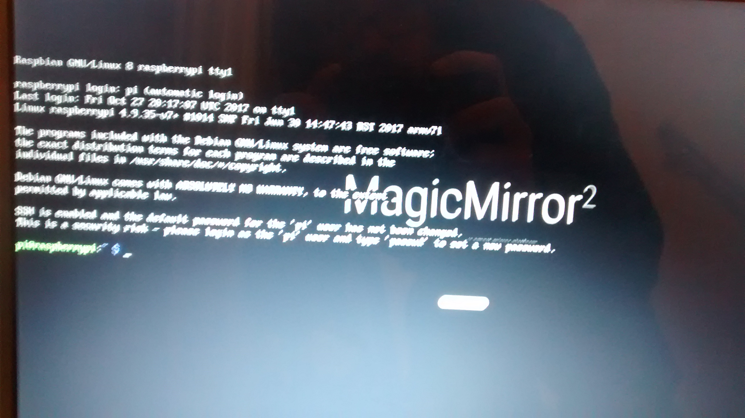

      Hello,
      Background info
      I burned magic mirror to an SD card a few months ago but then never did anything else with it.
      Today I put the SD card in my raspberry pi.
      The system booted up and then took me to a command line asking for a log in.
      I don’t remember having to log in the last time I set it up.
      My questions
      Is this a glitch or is there a default log in I need to enter?
      • randomnoiseR
        randomnoise
        Have you set it to autologin to GUI? Looks like you’ve got it set to login to console instead.
        sudo raspi-config then go to boot options.
        Text there is suggesting you change your password as well. Default user is pi with password raspberry
