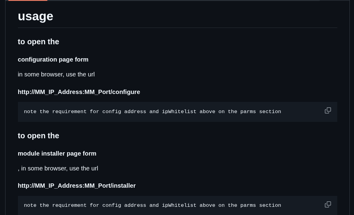

                            I added this section to the doc
                            after the parms and before the 1st screenshot
                            Reply Quote 1
