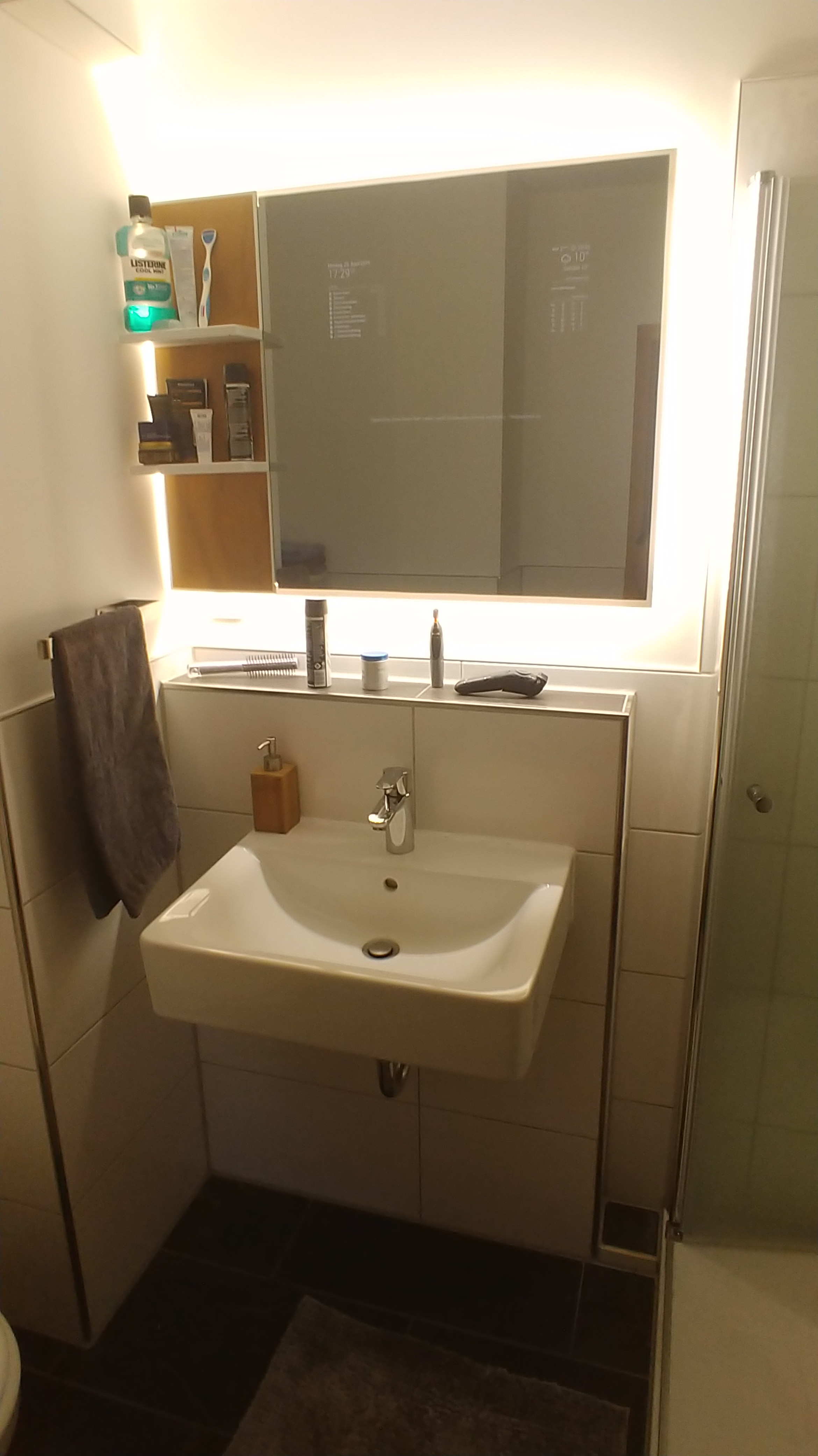

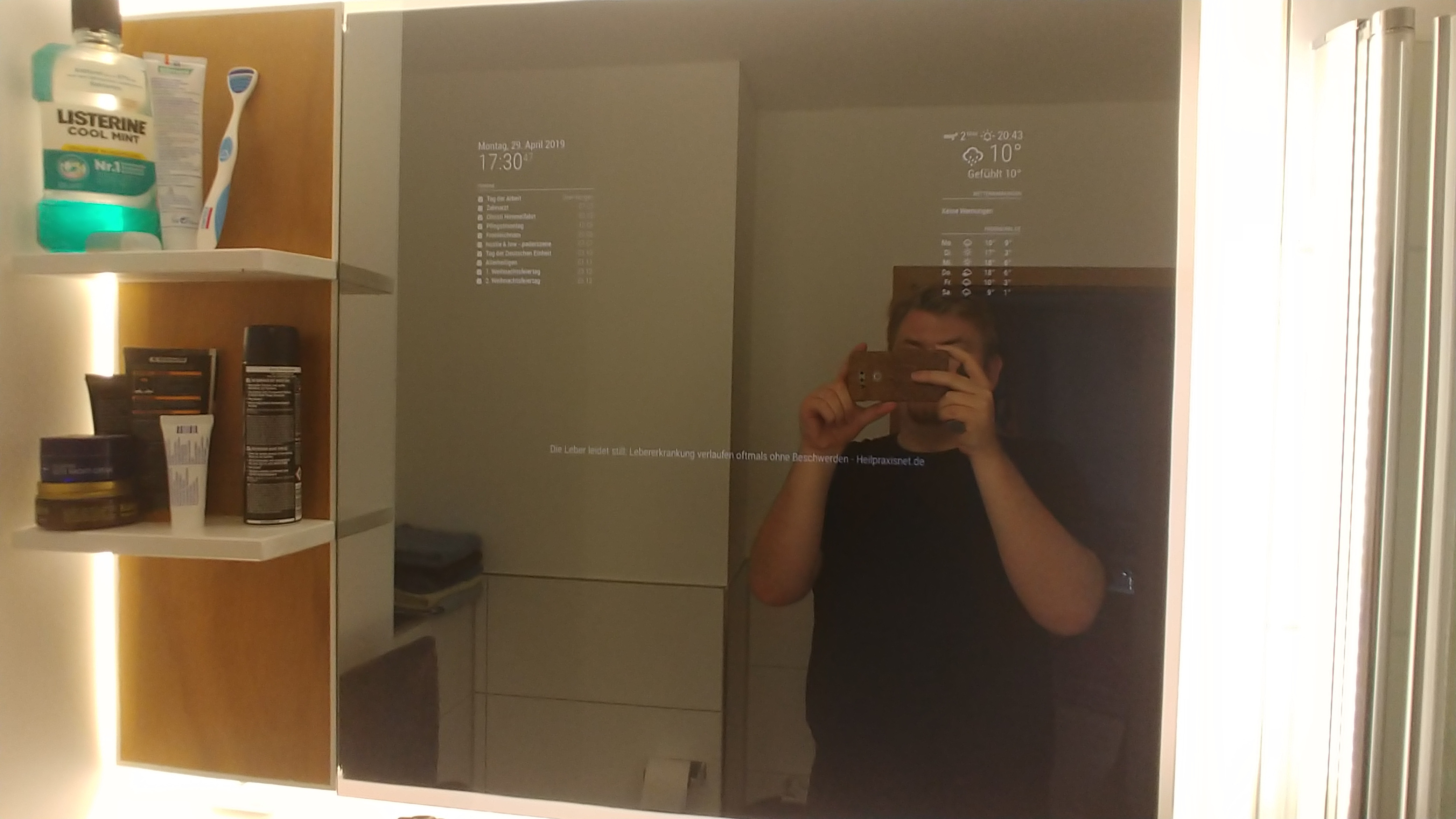

                    • C Offline
                      CluelessGenius
                      alright its not perfect but it works now and im kinda fed up with the whole topic of webbrowsing at minimal boot time so maybe ill try some things at some point for now im calling it.
                      right now i have magic mirror set up on a windows notebook (that i use for server tasks and that runs day n nite anyway) following the tutorial on this forum using git bash.
                      works perfectly and i personally find it much easier to handle / make changes and so on.
                      on the pi side i have a pi 3 b+ running chilipie-kiosk a ready to use kiosk image availble on github.
                      it works easily and user friendly out of the box. however i did whatever i could to tweak the boot time. by deactivating every service i didnt absolutly need. i also tweaked the config.txt to disable boot delay, splashscreen, audio and bluetooth and overclocked the pi as well as the sd card (didnt even know that was a thing :D).
                      oh and chilipie-kiosk implements a 15 second delay where it covers the browser windows up to hide chromiums page loading process which first i disabled but then noticed the whole screen would flicker white before the page was shown so i figured out that for my setup 5-6 also do the trick. im really not happy with that but im not going in for another try with some other browser setup.
                      i might try to start chromium a bit further up the chain/ earlier.
                      also i do still wanna try to make th whole thing read only / move the swapfile to a usb stick or maybe even the whole damn thing but with speed as a focus but more so for long term reliability.
