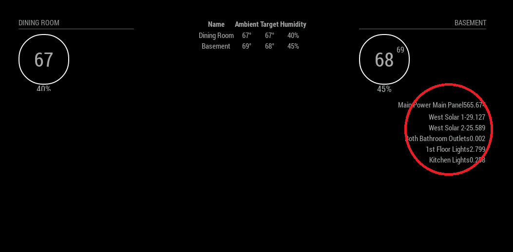

                How would I go about formatting my table? I would like to have each column have it’s own title, like “Load” and “kWh”. Is it also possible to put them into a tabulated table?
                My getDOM currently looks like the following:
                getDom: function(){
                        if(!this.loaded) {
                                wrapper.innerHTML = "Loading...";
                                return wrapper;
                        if(this.xml !== null){
                	 var table = document.createElement("table");
                         table.classList.add("xsmall", "table");
                         var channels = this.xml.getElementsByTagName("channel");
                         for(var i = 0; i < channels.length; i++){
                	   var row = document.createElement("tr");
                           for(var n = 0; n < channels[i].children.length; n++){
                		name = channels[i].getAttribute('name');
                		if(channels[i].children[n].tagName === "kWh"){
                                var element = document.createElement("td");
                		element.classList.add(channels[i].children[n].tagName);
                		if (channels[i].children[n].textContent != 0){
                			element.innerHTML = name + channels[i].children[n].textContent;
                			row.appendChild(element);
                			table.appendChild(row);
                         wrapper.appendChild(table);
                        } else {
                                console.log("Returned no Data");
                                wrapper.innerHTML = "NO DATA";
                        return wrapper;
                   parseXML: function(xmlStr){
                        return ( new window.DOMParser() ).parseFromString(xmlStr, "text/xml");
                • mochmanM Offline
                  mochman Module Developer
                  You should just need to put
                  var header = document.createElement("th");
                  var header2 = document.createElement("th");
                  header.innerHTML = "Load";
                  row.appendChild(header);
                  header2.innerHTML = "KWh";
                  row.appendChild(header2);
                  before
                  You can add a title by modifying your config.js file to add a header.
                  The documentation for that is here.
                  nbrennN 2 Replies Last reply Reply Quote 0

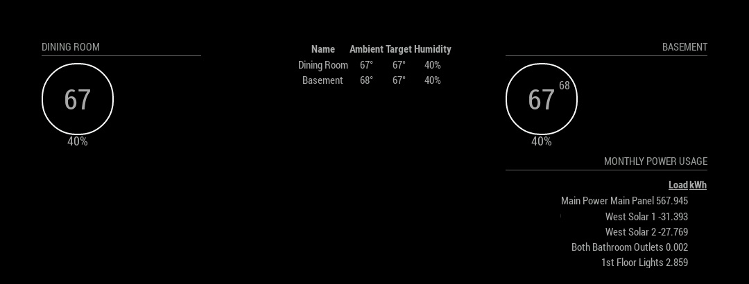

                      @mochman I have another question. As shown below in the attached image, I am appending the name to the kWh values. How do I put the name into the Load column and the numbers into their kWh column?
                      In this case, the “name” is in the same object as the channel, so that’s why I extracted it the way I do in my code… I have the name as a variable, but I can’t seem to put it into it’s own column.
                      Code:
                         getDom: function(){
                              if(!this.loaded) {
                                      return wrapper;
                      	 header2.innerHTML = "kWh";
                      			element.innerHTML = name + " " + channels[i].children[n].textContent;
                              } else {
                              return wrapper;
