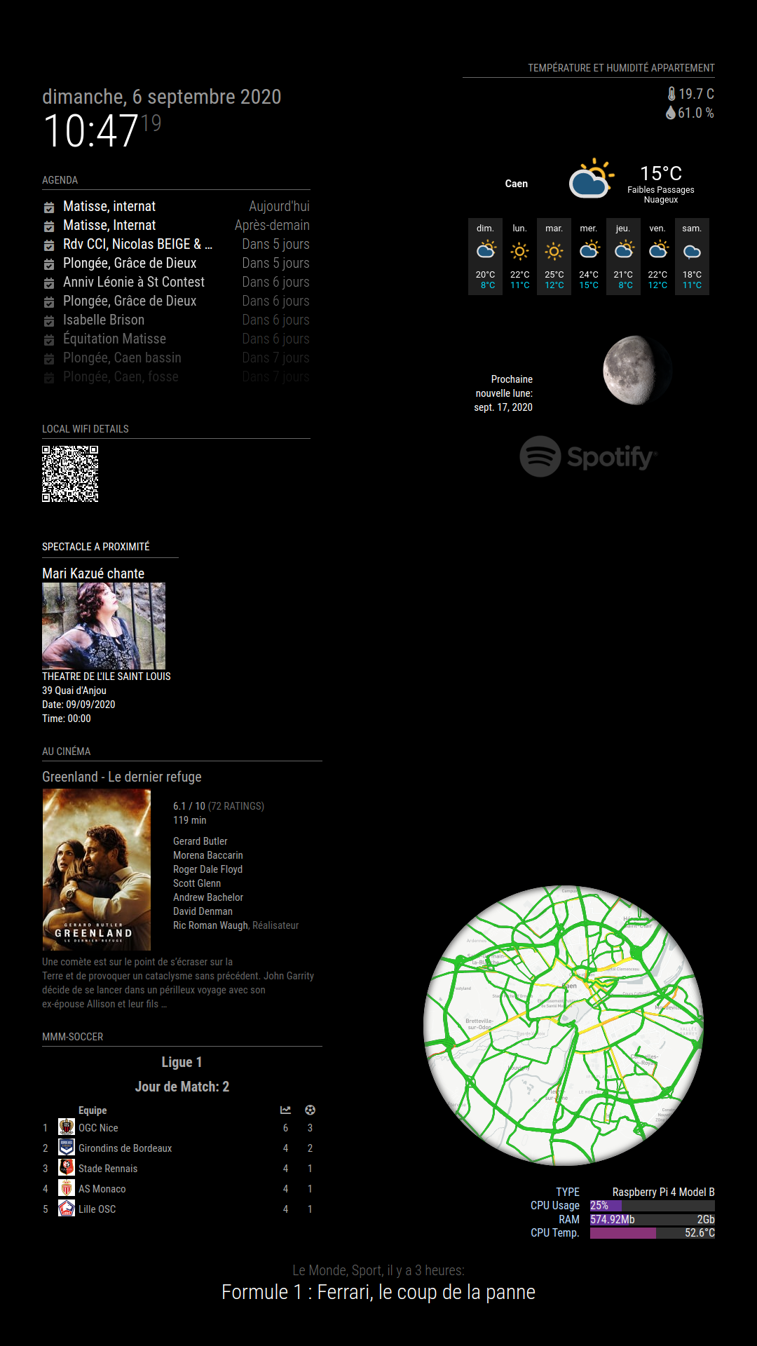

        RIKKO14
        Where is it on this page ?
          RIKKO14
          for the API key it’s ok, but i didn’t find yet how to delete the Rating line…
            sdetweil @RIKKO14
            @RIKKO14 open the developers window ctrl-shift-i on the keyboard. select the elements tab, and navigate the left panel to locate that module content.
            when u select it, the class tree will be shown at the bottom of the dev window nav, above the console area. the classes themselves will be shown on the right. top closest to the element, the bottom furthest away.
            this might help you find the css element to use adding
            display:none;
            in custom.css
            to make the content no longer shown
            u can test that by live editing the styles of the element to add that display setting
              sdetweil
              not gonna be so easy… he didn’t make it really selectable…
              easy with a code change
              edit MMM-MovieListings.js
                  pageChangeInterval: 30 * 1000,
                  showRatings: true                                      // < -- add this line, line 25, notice the comma on the line before
              add this line
                  // Add all details
                  if(config.showRatings)                   // < ---- line 235
              save file
              then add to your config.js for this module
                 config : {
                   showRatings: false,
                RIKKO14
                it does not work, tan worse I leave it like that. Thank you for your help…
