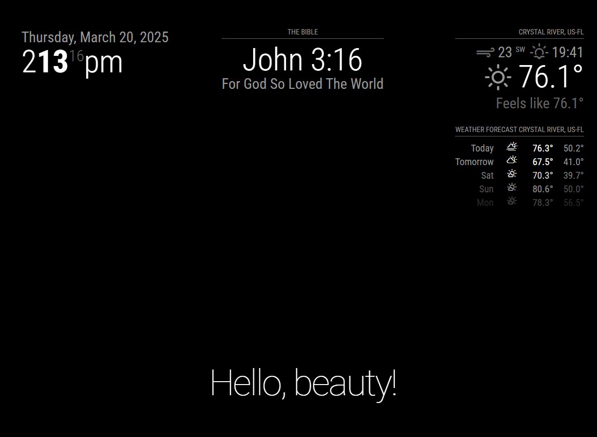

        FYI update showing the display that I got working.
        S 1 Reply Last reply Mar 20, 2025, 6:31 PM Reply Quote 1
        • S Away
          sdetweil @PGP_Protector
          @PGP_Protector awesome!!
