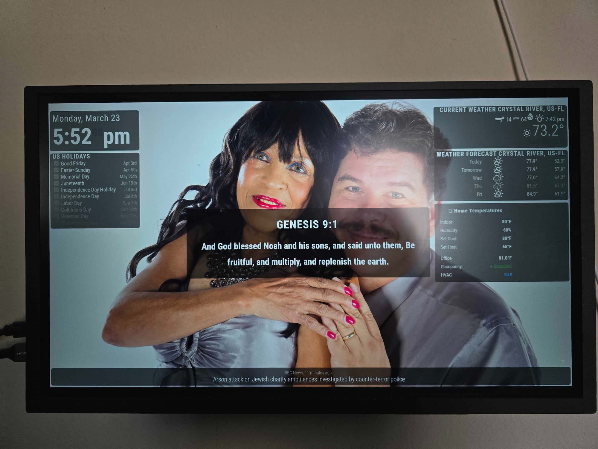

      Had an install but forgot my user / pw to the pi so decided to do a clean install.
      But with a bit more fun?
      So I decided to have Claude help me redo it all.
      Started with the clean install, then had it help me install an SQL Server (For the Bible Quotes in the center)
      Had it help me write the module to directly access the DB for the books / chapter / verse / text configurable with update speed / bible language (got 2 tables I can switch between ASV or KJV)
      Then had it help me configure my Ecobee connection (newer module ecobee so had a hard time getting access to it’s api points) but I did have home assistant running on a nother pi box. And claude helped me connect to that instead to get the Home Tempratures section.
      Finaly had it add a custom background rotating module that pulls images from a local folder and add overlays to the different modules.
      So far I’m liking the results.

      FYI update showing the display that I got working.
