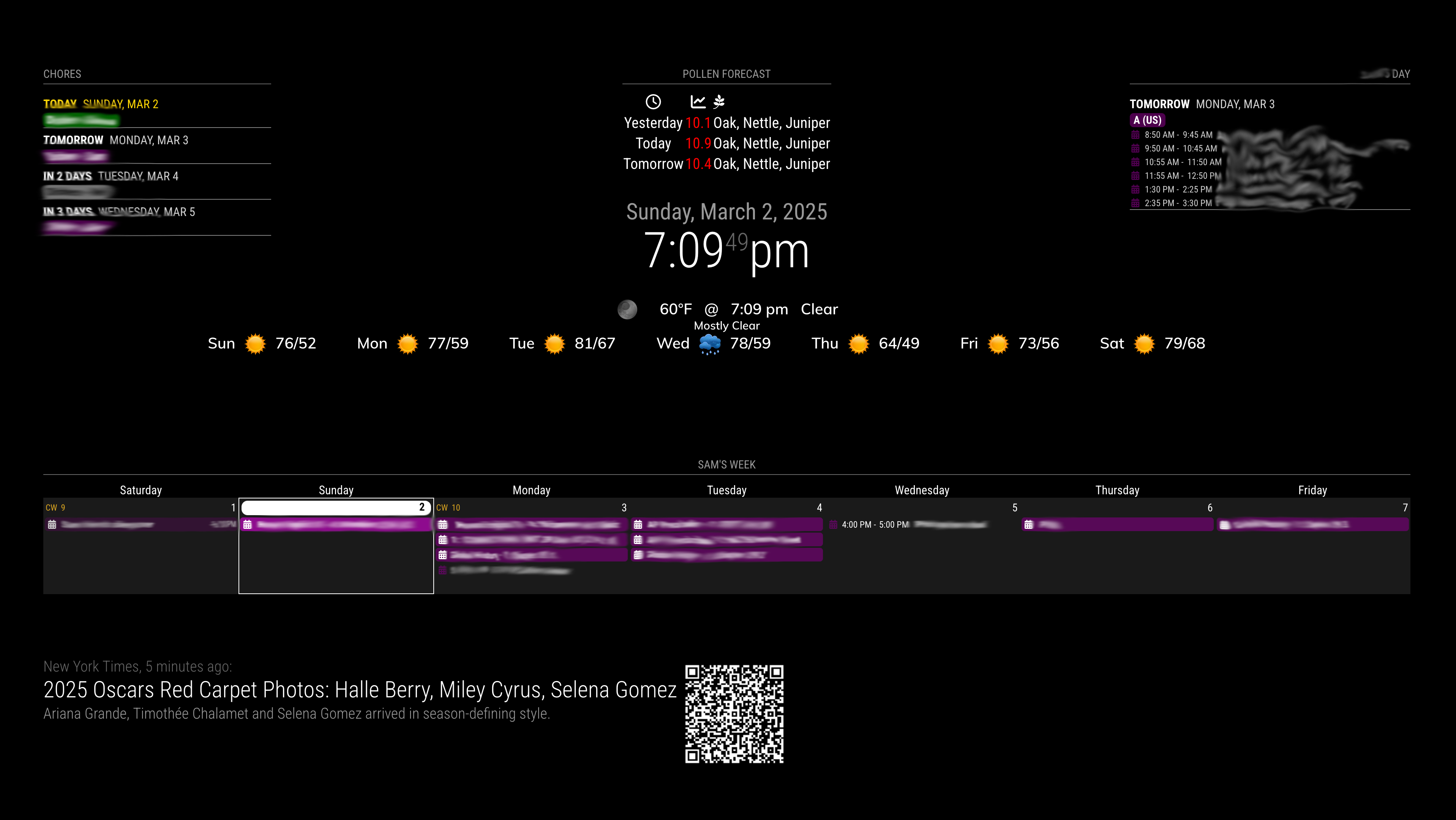

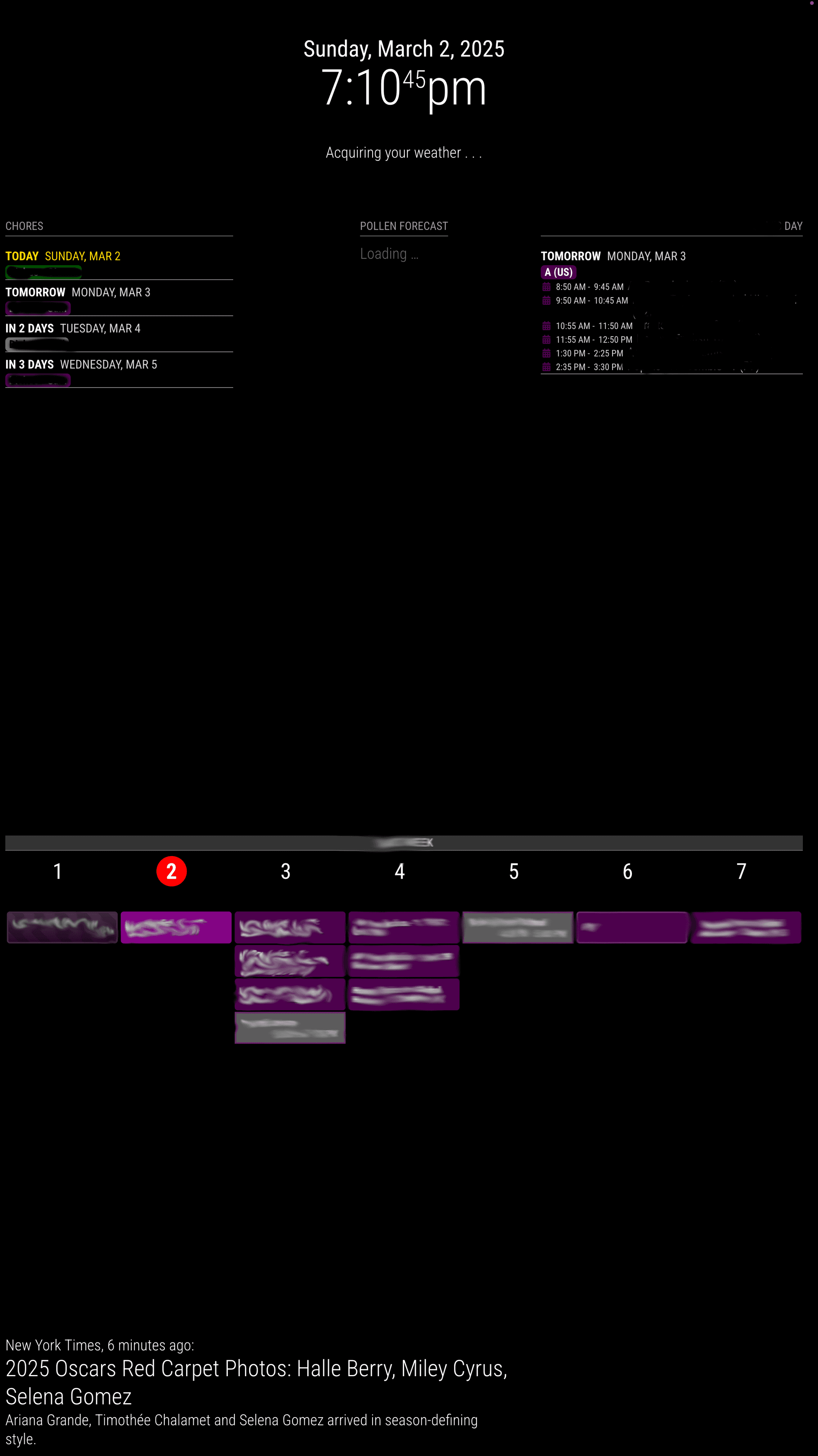

These use the same config file and only minimal changes to CSS for landscape. My primary screen that’s on all the time is in portrait. The clock and MMM-BMW-PW was shifted from top_bar to upper_third. The newsfeed was moved from bottom_left to bottom_bar. MMM-News-QR was moved from bottom_right to bottom_bar. More drastic maneuvirng can be accomplished by incorporating CSS changes like the example posted here https://forum.magicmirror.builders/topic/13197/change-the-regions-positions
PORTRAIT:
LANDSCAPE:
