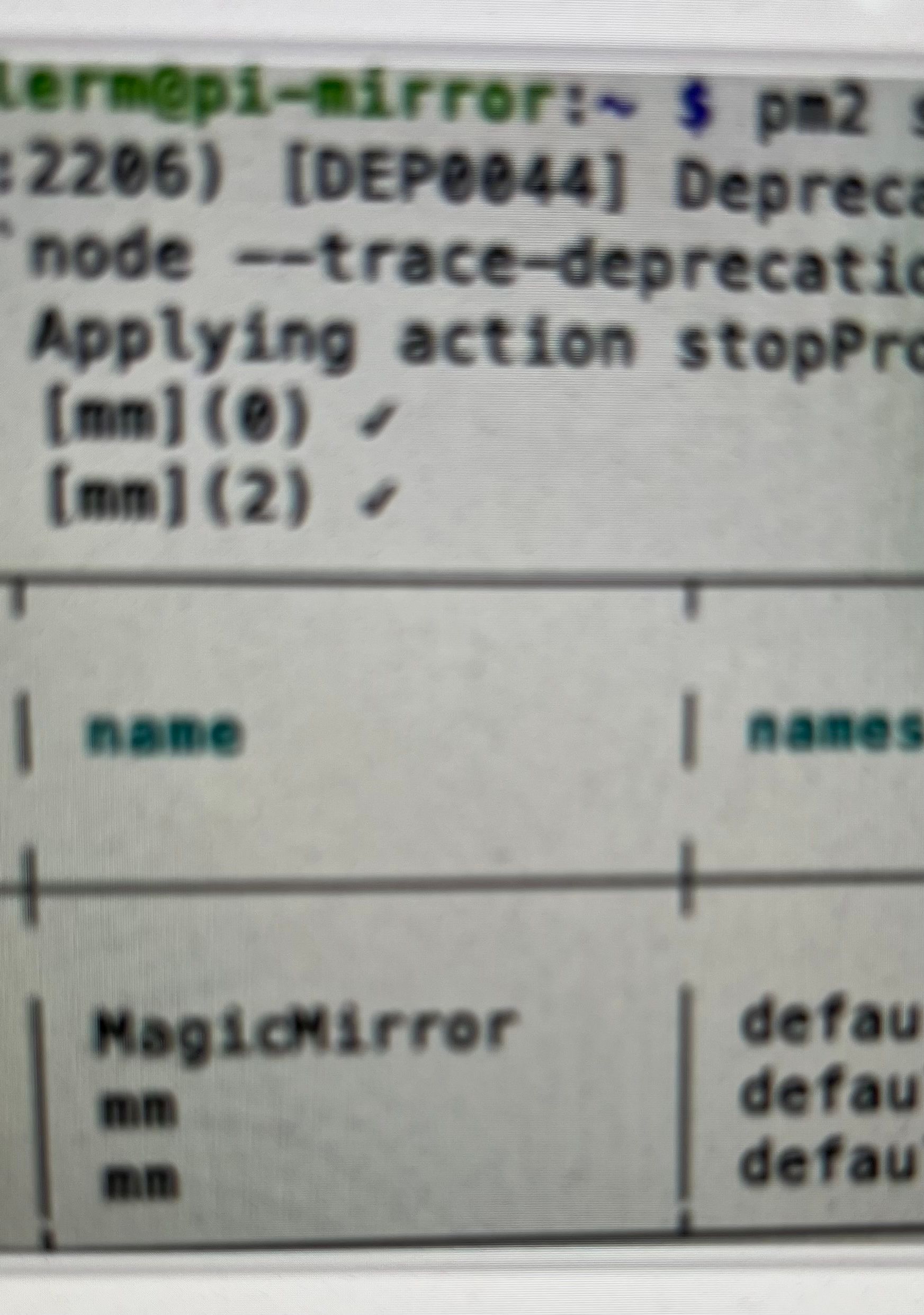

      When I use pm2 to either start or stop my MagicMirror I get three processes: MagicMirror, mm and another mm.
      I would think they conflict. I’ve searched online but haven’t found a solution. I’d like to delete one of the two mm processes. Can anyone help? I’m a novice with Linux and Magic Mirror. Thanks.

        @sdetweil I was able to successfully use “pm2 delete 2” and save my efforts. The mirror seems to be responding faster now. Thanks for your help.

            @EngrAg81 if you started mm with your own mm.sh then it creates one with mm as the name
            my installer creates the MagicMirror one
            pm2 has commands to manage the list
            pm2 --help
            pm2 delete xxx
            xxx is the name or row number… as shown by pm2 status
            as you have multiple mm, then name is ambiguous, use the number in front
            pm2 save
            after removing the extras
            in general ALL linux commands have help via --help (by convention, rules)
