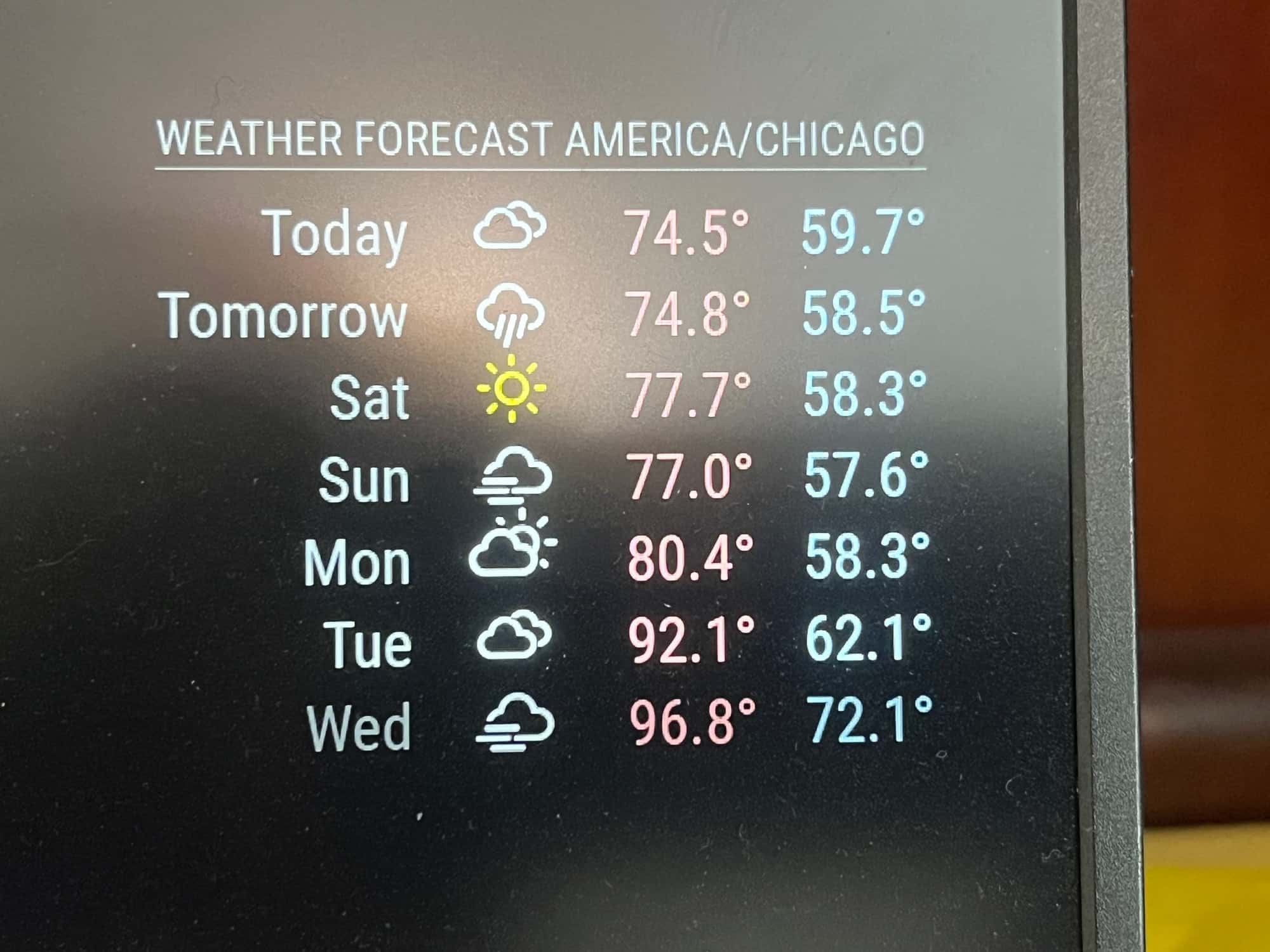

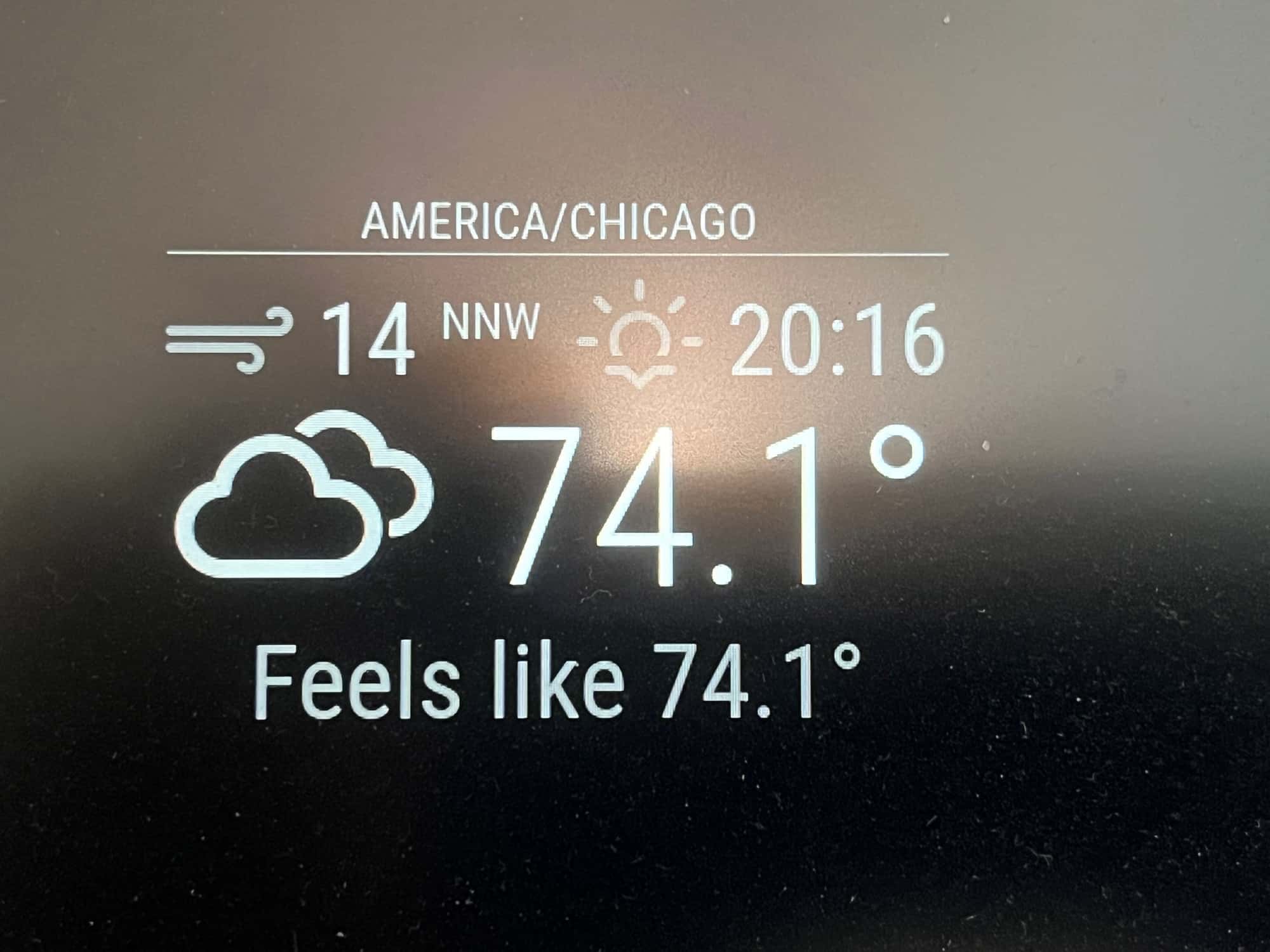

    • Location display of weather module is incorrect
      I am using the weather module with openweatherMap and lat long of my location (Ft Worth, TX). However the display on the magic mirror says “America/Chicago”. How do I change it to Ft Worth?
      I have not seen anything in the documentation that will help.
      Additional info:
      I use an API key and weatherEndpoint “/onecall”
      I tried using Location and locationID but later saw in the documentation that using lat long causes the module to ignore those entries.
      I confess I am new using MagicMirror software.
      Thanks for any help.
