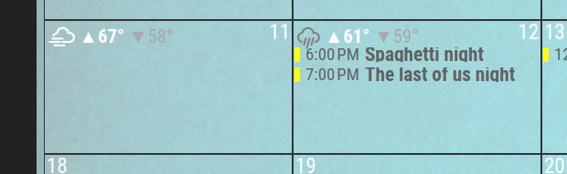

    • RE: MMM-CalendarExt3 shows both start and end time. How to stop showing end time.
      @EngrAg81 Ok, I think this is what you would edit to change the way those numbers are displayed, ie, High/low temp. This will be in the custom.css.
      CX3 .cellHeader .cellWeather .maxTemp {
        color: white;
        font-weight: bold;
        font-size: 90%;
      .CX3 .cellHeader .cellWeather .minTemp {
        color: darkgray;
        font-weight: normal;
      .CX3 .cellHeader .cellWeather .temperature {
        display: var(--displayWeatherTemp);
        padding-left: 5px;
        font-size: 90%;
      .CX3 .cellHeader .cellWeather .maxTemp::before {
        content: " \25b2";
      .CX3 .cellHeader .cellWeather .minTemp::before {
        content: " \25bc";
      .CX3 .cellHeader .cellWeather .temperature::after {
        content: "° ";

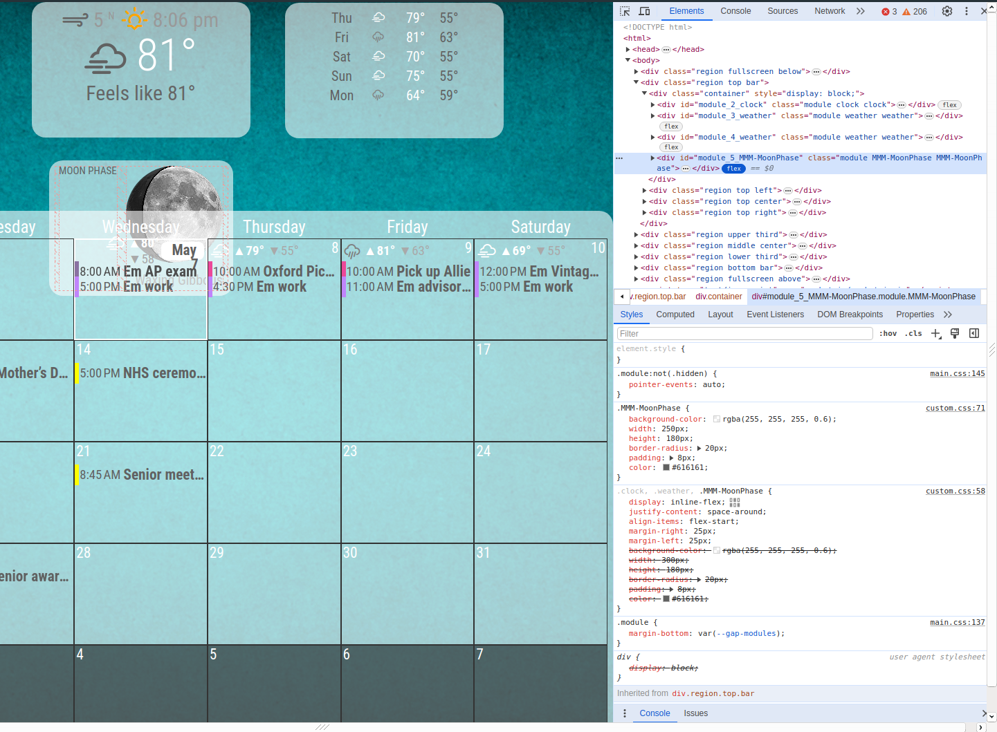

      bobbylx
    • RE: Help with a flexbox item that is not aligning.
      @sdetweil I’ve gone through a plethora of pages regarding Flexbox. What I am failing to understand, and probably in part due to my limited coding experience, is why only that single item of the 4 is not cooperating.
      The way I understand is I have the flex container, which in this case is the top_bar? Then I have items within the container. My flex items would be the .clock, .weather, .weather and .MMM-MoonPhase. So should I be using a word other than .MMM-MoonPhase when adjusting the flex box position? Such as, in the example below, should .MMM-MoonPhase be replaced with another code that will then apply to the moon phase? This is where it gets muddy for me. And I know the second MMM-MoonPhase down there by itself is redundant, I was just testing.
      .clock, .weather, .MMM-MoonPhase {
      	display: inline-flex;
      	justify-content: space-around;
              align-items: flex-start;
              margin-right: 25px;
      	margin-left: 25px;
              background-color:rgba(255, 255, 255,0.6);
              width: 300px;
              height: 180px;
      	border-radius:20px;
              padding: 8px;
              color: #616161;
      .MMM-MoonPhase {
      	background-color: rgba(255, 255, 255, 0.6);
      	width: 250px;
      	height: 180px;
      	border-radius:20px;
              padding: 8px;
              color: #616161;
      So if bring up the developers window, and change the inline-flex, align-items, they all 4 move around, just that single Moonphase is slight off from the others.
      Honestly, I’ve been tweaking and editing this thing for a good year or so, I might be better off making a backup of some stuff and starting fresh.
      posted in Custom CSS

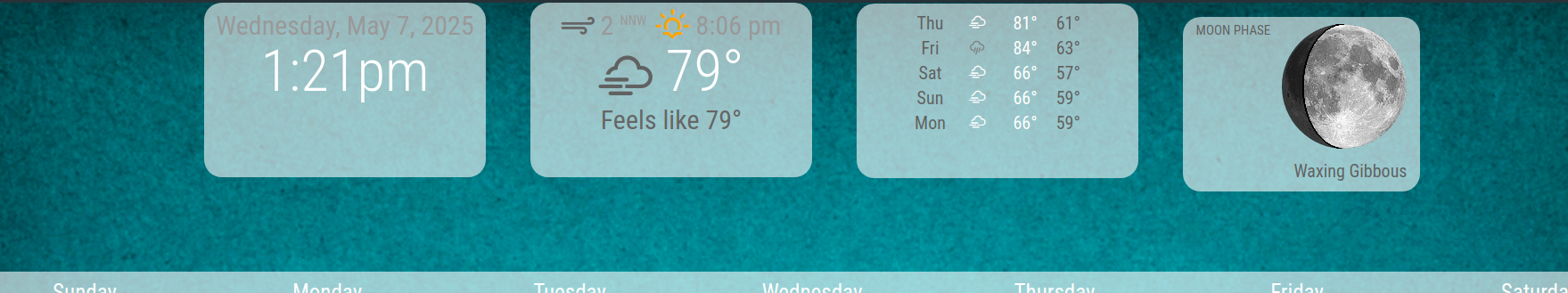

    • Help with a flexbox item that is not aligning.
      Hello all,
      Looking for a little advice on this. I have 4 modules positioned in my top_bar and I have then in a flexbox. 3 of the 4 items are lined up with the top of the box, but the 4th will not move. I’ve used the developers window to inspect elements and make changes on the fly, but no matter what I change, in either the custom.css or main.css that goofy Moonphase module will not line up. Even if I change the flex alignment, all the modules will change position, just that moon module is never in sync with the others if that makes sense. Anyway, is there a tool or way to determine if that module is being positioned by another css file? Any other suggestions are welcome.
      Here is my custom.css for reference.

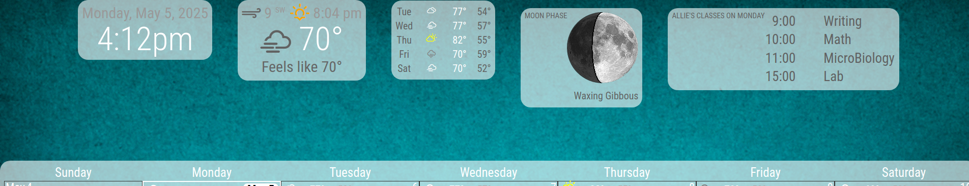

    • MMM-CalendarExt3 formatting tweaks
      Hello all, just have 2 questions that have me stumped.
      1. I would like to have the modules across the top lined up, and preferably same sized backgrounds. I’ve tried adjusting the margins, but for some reason cannot make the Moon phase and Lesson plan module move up. Any suggestions?
      2. Can someone tell me where to add padding or what margin to adjust to add space between my individual events? thanks in advance.
