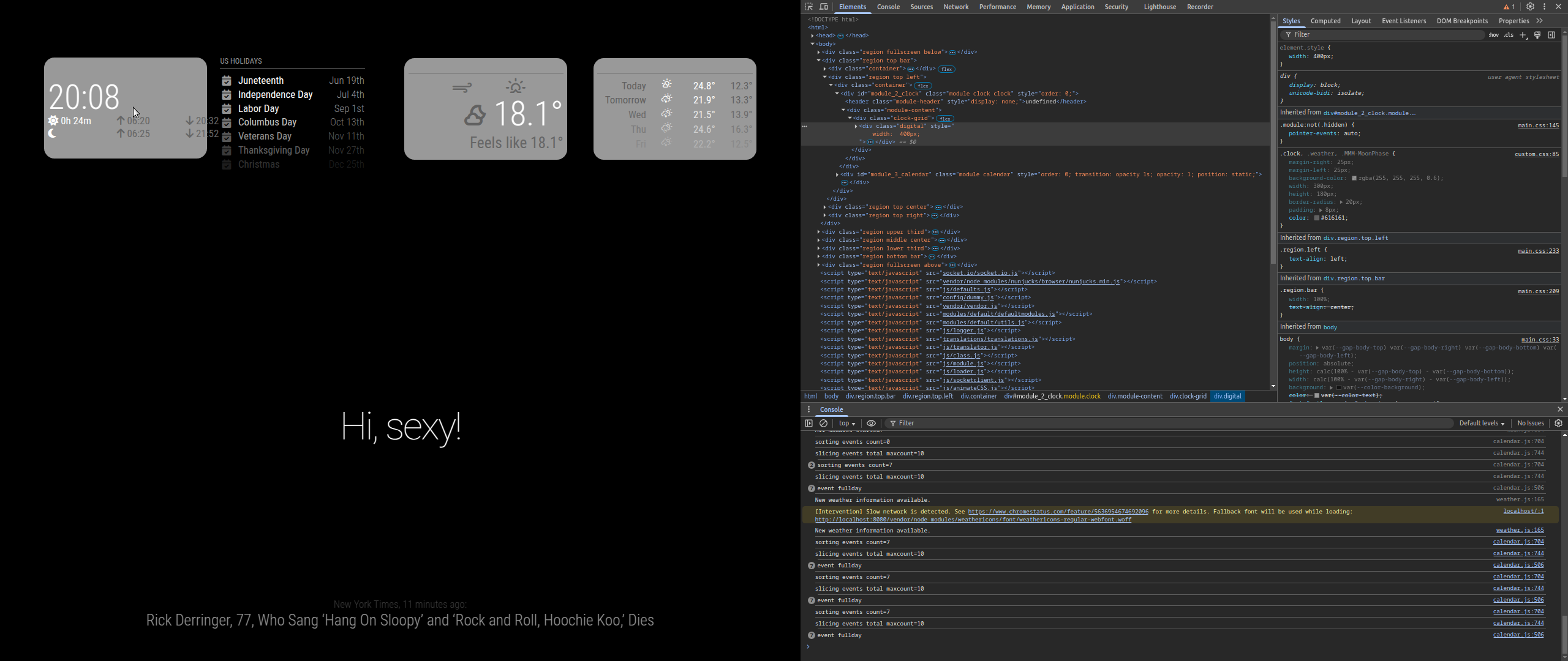

      Dear all,
      I’ve tried desparately the developer’s console to figure it out and tried to get hints in given postings but no luck…
      Since days become longer the day time is written with more letters and so I see a line wrap in the day time of clock module (in this example 11h17m)::
      Can please anybody help me with aligning this?
      Developers console is nearly unusable because I have an anaolog clock and the transformation hits every second and destroys focus.
      I’ve menaged at least to get the HTML at this section:

        sdetweil @rkorell
        @rkorell I think if you set
        .clock .digital {
           width: 400px;
        using the sample config plus the showMoon/showSun true
        displaySeconds:false
