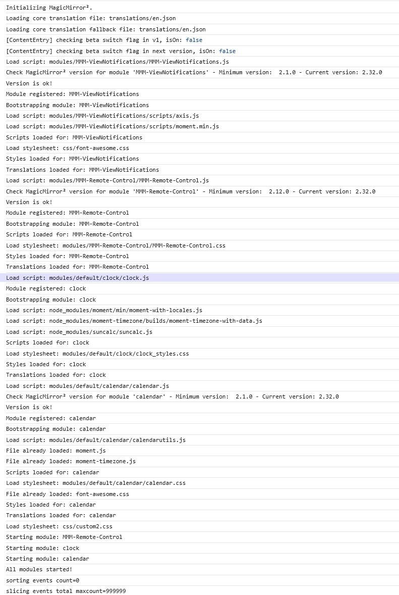

                      When I load the mirror in chrome/brave I get this in console:

                          @BKeyport those look like browser side messages not server side
