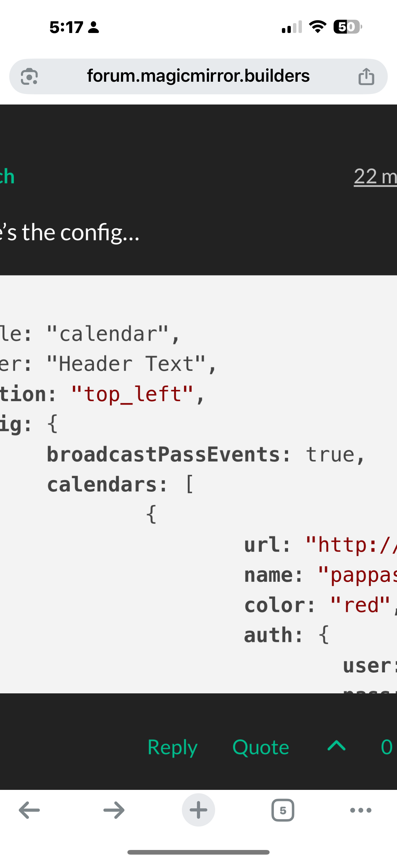

          @sdetweil here’s the config…
          			header: "Header Text",
          				broadcastPassEvents: true,
          						url: "http://localhost:8080/CALDAV/XXX.ics",
          						color: "red",
          						auth: {
          							user: 'icsuser',
          							pass: 'icspass',
          							method: 'basic',
          S 3 Replies Last reply Reply Quote 0

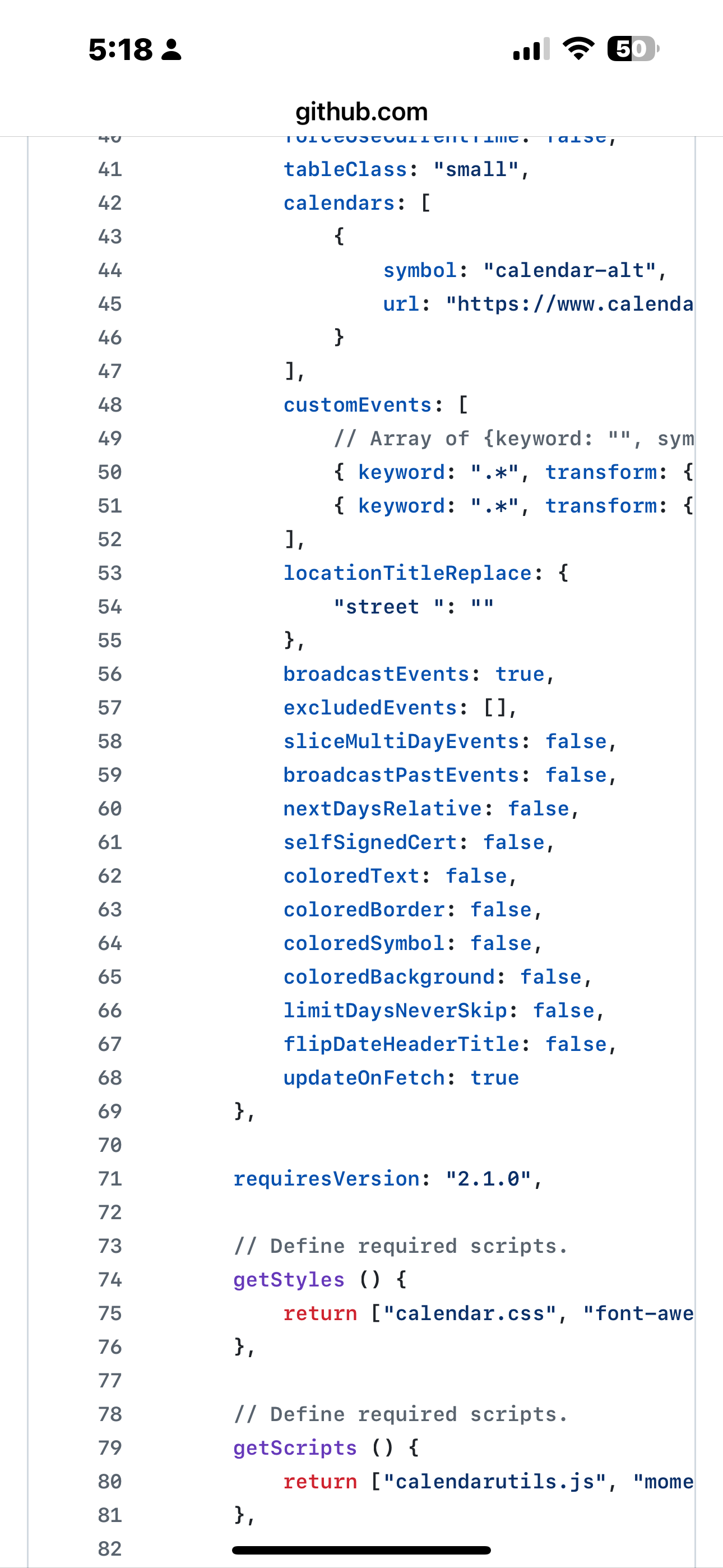

              sdetweil @pappastech
              @pappastech you have a typo
                @pappastech
                pastEvents
                P 1 Reply Last reply Reply Quote 0
