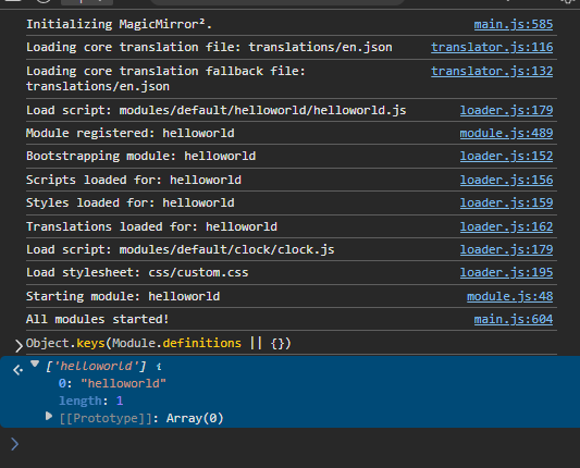

          And interestingly, some output from the browser console that seems to show clock is loaded, but not registered to java.? ( custom.css is also loaded but its a zero byte file)

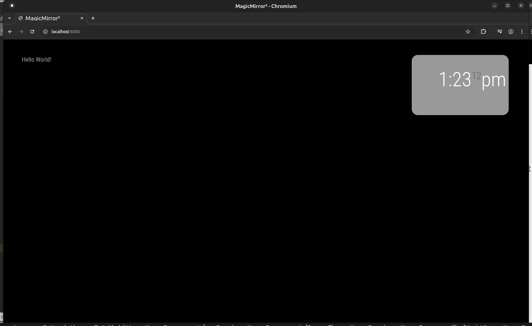

            now, I made a new config with you config data and get as expected frm my chrome browser looking at the server port
