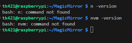

      Node 23 is bad , so we won’t install there
      So try either of these commands
      n —version
      nvm —version
      Do either exist?

        @sdetweil it appears neither do

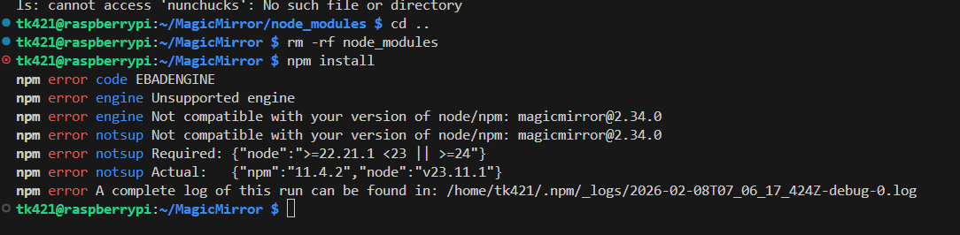

            @sdetweil IT WORKS!! I cannot thank you enough for your time and patience with the help on this. I have learned alot from walking through this troubleshooting with you. Are you able to tell me what I may or may not have done wrong to cause it to stop working?

              You upgraded nodejs at some point
              And didn’t catch the npm install error message
              So you had the new code (git pull) but not the runtime libs it needed

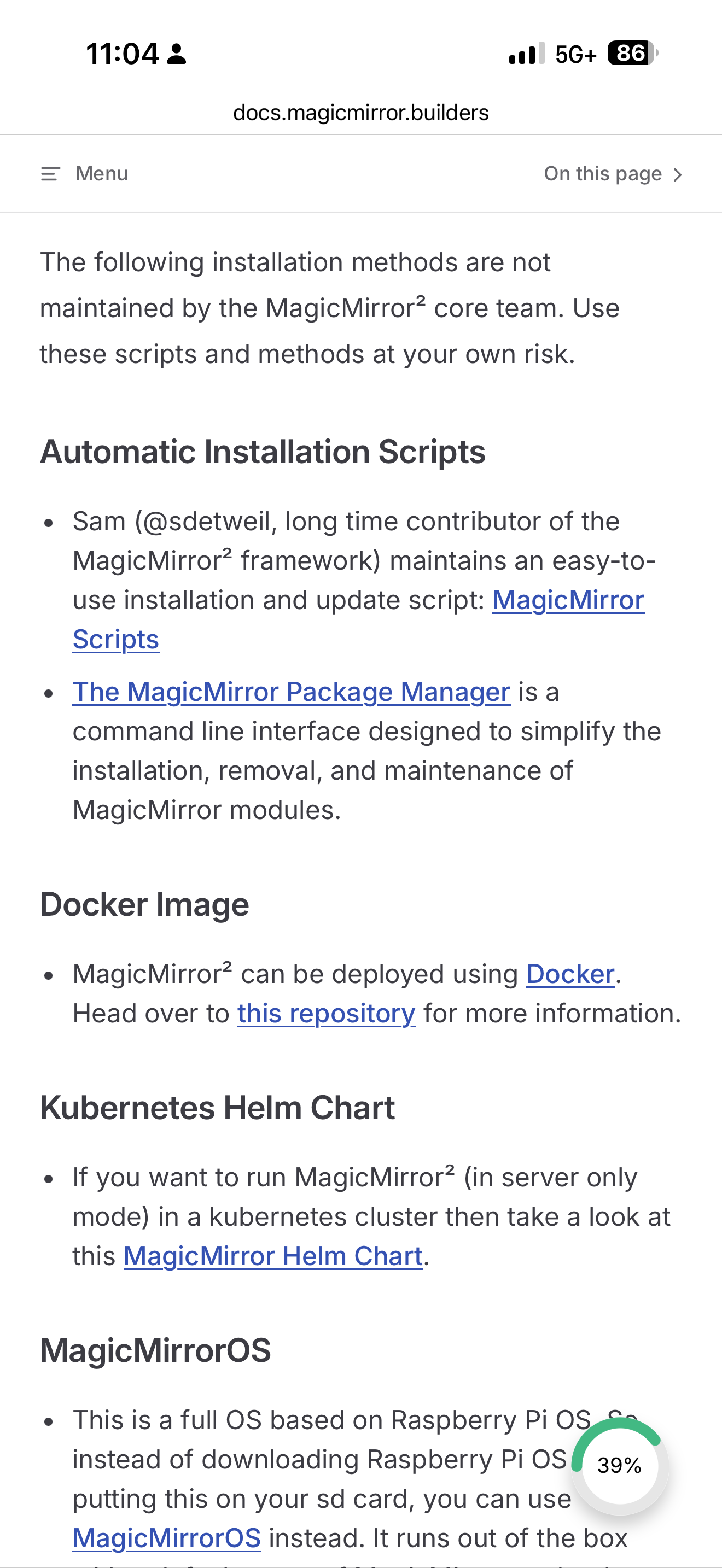

              I recommend using my upgrade script in the future

                @sdetweil gotcha! I would love to use a script instead of breaking things again lol where can i find your upgrade script and what does it all entail? does it upgrade Magic mirror and the modules or just MM itself?
                  sdetweil @fnmuffinman
                  @fnmuffinman the links are in the MagicMirror documentation
                  It does only MagicMirror
