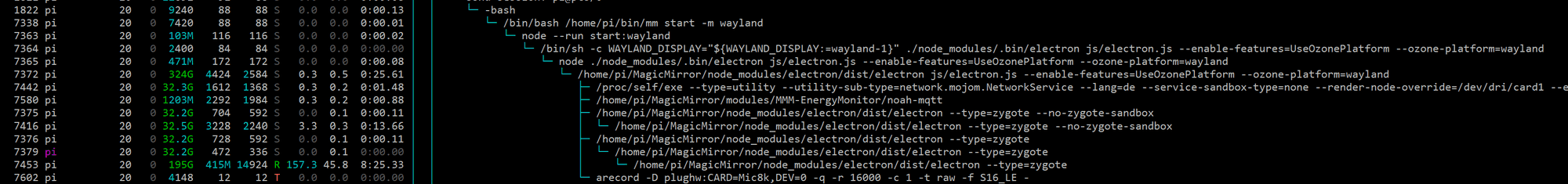

          But I’m now faced with another big issue under Trixie. If I schedule modules using graphic functions like vlc, the CPU load increase dramatically. There is one electron process with parameterer –type=zygote consuming the whole CPU capacity.
          From copilot I got the answer: High CPU usage from electron --type=zygote is usually tied to Chromium’s zygote process, which forks renderer processes.
          Do you have any idea how to get this problem under control?

              After further investigations I found the reason for the heavy CPU load. Originator for this behaviour ist the parameter “ELECTRON_ENABLE_GPU=1”. If this parameter is undefined my CPU load is as expected.

                @Mr.Sponti do you have the gpu hardware enabled?
                If not then I think electron tries to emulate it, probably w the vlc content
