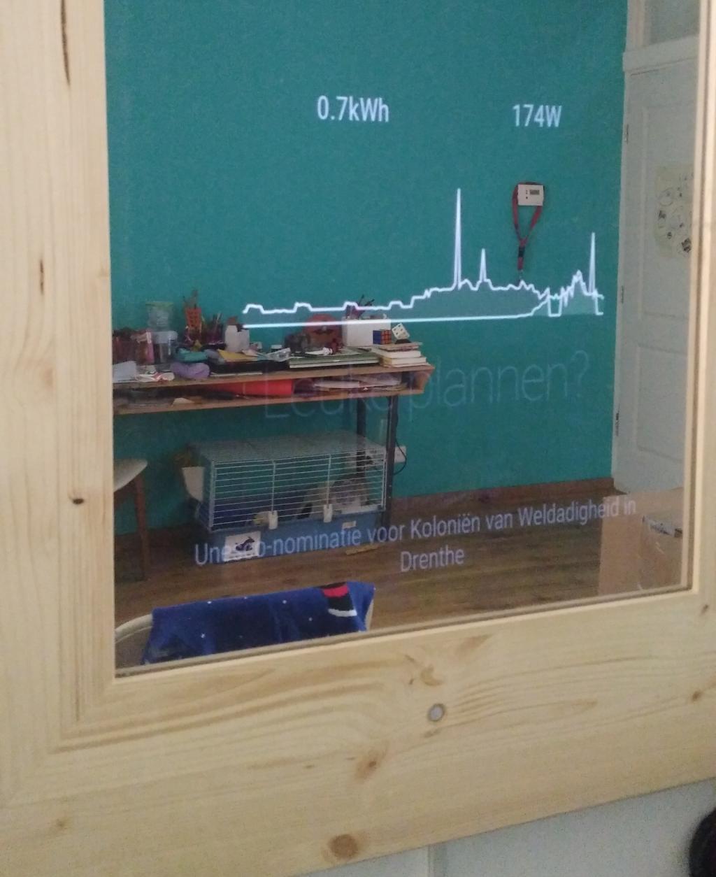

          <a class=@mrvanes Thanks for your great work! I was just what I was looking for. It works perfectly." class=" img-fluid img-markdown" />
            skipperskip @skipperskip
            @skipperskip said in PVOutput widget module:
            ![@mrvanes Thanks for your great work!
            I was just what I was looking for. It works perfectly.]
