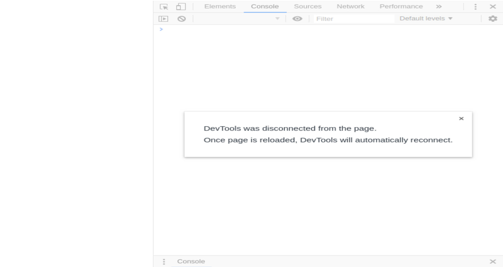

      Hi, I’m a beginner in the whole Module developmment thing.
      but as I created a first test module, everytime I wanted to start the MM with my module in the config it crashed. If I use default Modules it works fine. here are two screenshots. the first one is my error message and the second one is how my MM looks oon booutup with my module in the config.
      screenshot 1: https://gyazo.com/b33e81a5acfbaa7b0191c1a49c0ecddb.png
      screenshot 2: https://i.gyazo.com/f8a216fdc602a0d890dbbf4b34c2a5b1.png
      edit: i tried putting my code into the js file of a default module and the code works so maybe it’s somethng in the name resolution of the module …

              https://i.gyazo.com/0ff68f840855d70a80817f3bd75882e0.png
                sdetweil @vredevol
                @vredevol getDom() MUST return AT LEAST an htmlElement
                add return document.createElement(‘div’)
                see my sample module
