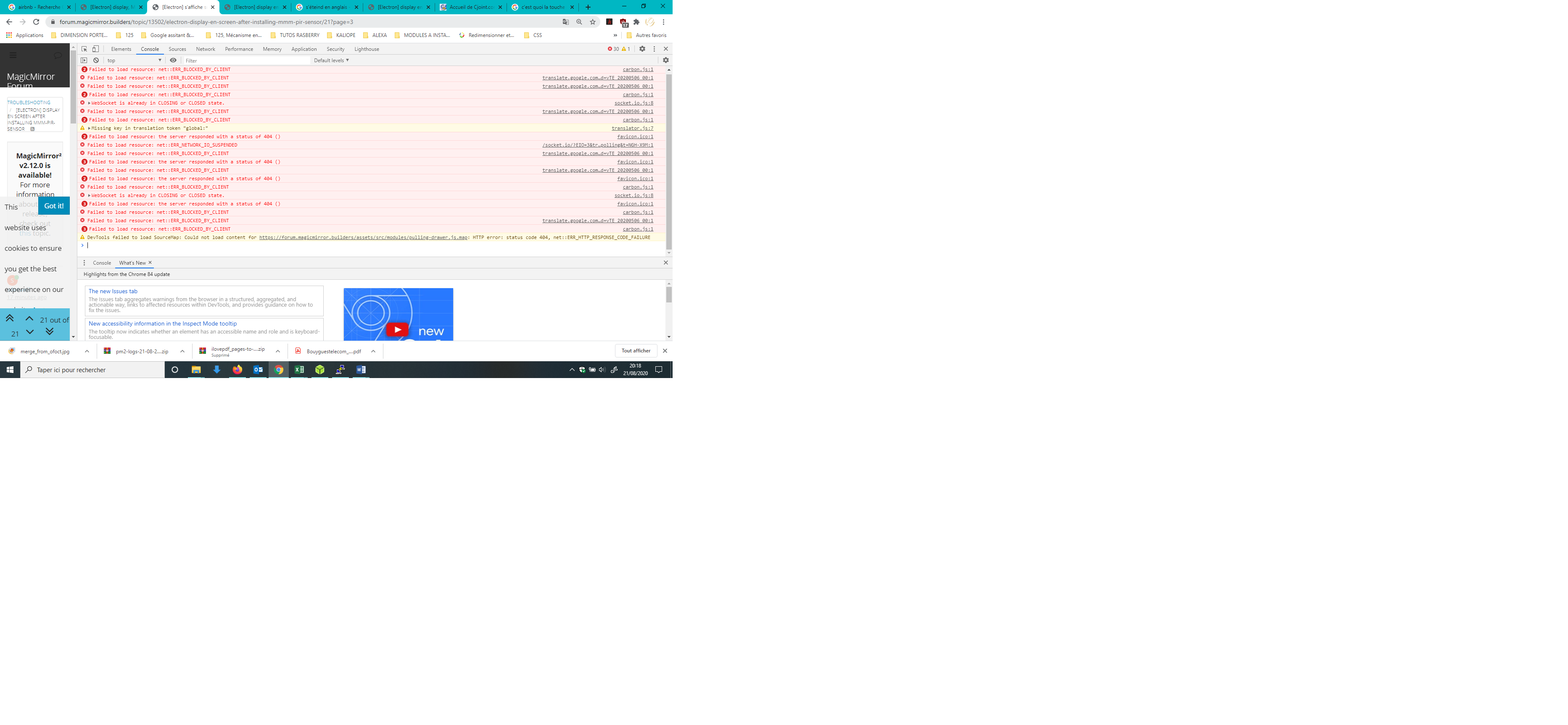

      I’m lost, can you tell me another time the electron rebuild procedure you posted.
        RIKKO14
        my logs :
        pi@raspberrypi:~ $ pm2 logs --lines=100
        [TAILING] Tailing last 100 lines for [all] processes (change the value with --lines option)
        /home/pi/.pm2/pm2.log last 100 lines:

        /home/pi/.pm2/logs/mm-error.log last 100 lines:
        0|mm       |     at Class.addons (/home/pi/MagicMirror/modules/MMM-Assistant2Display/node_helper.js:1:5076)
        0|mm       |     at Class.initialize (/home/pi/MagicMirror/modules/MMM-Assistant2Display/node_helper.js:1:3566)
        0|mm       |     at MD5.cb (/home/pi/MagicMirror/modules/MMM-Assistant2Display/node_helper.js:1:807)
        0|mm       |     at MD5.start (/home/pi/MagicMirror/modules/MMM-Assistant2Display/node_modules/@bugsounet/md5/index.js:1:1719) {
        0|mm       |   code: 'EADDRINUSE',
        0|mm       |   errno: 'EADDRINUSE',
        0|mm       |   syscall: 'listen',
        0|mm       |   address: '::',
        0|mm       |   port: 8569
        0|mm       | }
        0|mm       | [2020-08-22 18:33:41.663] [ERROR]  MagicMirror will not quit, but it might be a good idea to check why this happened. Maybe no internet connection?
        0|mm       | [2020-08-22 18:33:41.665] [ERROR]  If you think this really is an issue, please open an issue on GitHub: https://github.com/MichMich/MagicMirror/issues
        0|mm       | [2020-08-22 18:36:30.379] [ERROR]  Whoops! There was an uncaught exception...
        0|mm       | [2020-08-22 18:36:30.380] [ERROR]  Error: listen EADDRINUSE: address already in use :::8569
        0|mm       |     at Server.setupListenHandle [as _listen2] (net.js:1226:14)
        0|mm       |     at listenInCluster (net.js:1274:12)
        0|mm       |     at Server.listen (net.js:1362:7)
        0|mm       |     at Function.listen (/home/pi/MagicMirror/modules/MMM-Assistant2Display/node_modules/express/lib/application.js:618:24)
        0|mm       |     at DialServer.start (/home/pi/MagicMirror/modules/MMM-Assistant2Display/node_modules/@bugsounet/cast/index.js:90:23)
        0|mm       |   port: 8569
        0|mm       | }
        0|mm       | [2020-08-22 18:36:30.382] [ERROR]  MagicMirror will not quit, but it might be a good idea to check why this happened. Maybe no internet connection?
        0|mm       | [2020-08-22 18:36:30.383] [ERROR]  If you think this really is an issue, please open an issue on GitHub: https://github.com/MichMich/MagicMirror/issues
        0|mm       | [2020-08-22 18:41:28.797] [ERROR]  Whoops! There was an uncaught exception...
