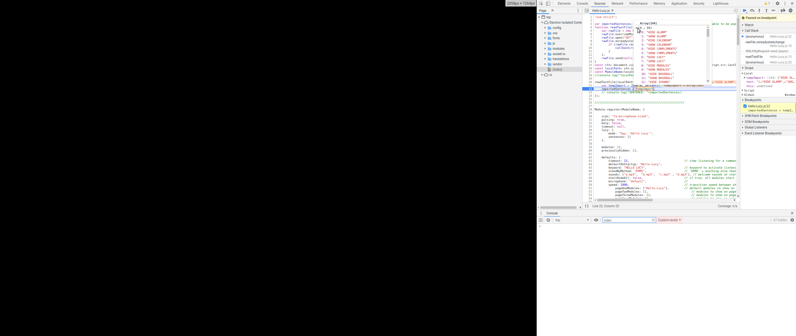

            sdetweil @Nicodil
            @nicodil I JUST tested and it worked…
            in the sources view
            find the module and source file (left nav) and put a stop (click the number on the left edge of the line) on line 27
            then hit f5, refesh page
            hover over the variable and expand the array

                            It looks like it is reading now the sentences.json. Im not sure why, the error was not shown anymore after a few restarts and changes.
                            BUT still Lucy understands only nonsence, only the words in the words.json…
                            The Array of the sentences is there, like in your picture, so it is read.
                            She still cannot understand “Show modules” or “Hide Modules”, only words like “the”, “who” , …
                            Any idea?

                                    @nicodil ok, so you will have to go into the developers window to help me
                                    ctrl-shift-i
                                    select the sources tab
                                    find the module in the left nav, and Hello-Lucy.js
                                    and click the number on the left column
                                    for line 15 var sfn=
                                    then hit f5 refresh
                                    it will stop at line 15, then using the mouse hove over the .src of document.currentSrc.src
                                    take a screen shot of that
                                    N 1 Reply Last reply Reply Quote 0
