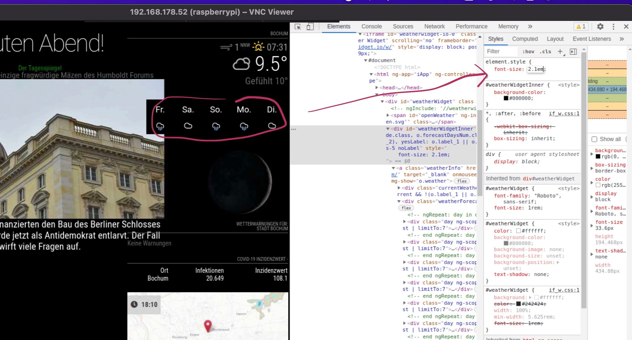

      I need help with custom.css. I would like to enlarge the forecast area to about 1.5em. Unfortunately I can’t get any further with my custom.ccs.
      .MMM-WeatherOrNot .day ng-scope {
        font-size: 1.5em; */
      oder
      .MMM-WeatherOrNot .weatherForecast{
        font-size: 1.5em;
      can someone help me please
      thx
        sdetweil @bjoern
        @bjoern find day in the bottom window and then in the top of that bottom window where it says
        just so u can see what it defines… u can override everything… don’t need a special class
        element.style {
        u can add/edit styles it will help you
        then when u get it the way u want, you can mark the element.style thing
        and copy/paste it to custom.css
        also
        item selection/targeting is
        . means class
        no dot means html element name (body, div, li, …)
        u have
        class, class, element but ng-scope is a class

          Thanks for the hint. I was able to change the font size in dev-mode, but I can’t find the right element name
          .MMM-WeatherOrNot .weatherWidgetInner  {
              font-size: 2.1em;
          .MMM-WeatherOrNot div.weatherWidgetInner.ltrforecast.forDays-5nolabel  {
              font-size: 2.1em;
            sdetweil @bjoern
            @bjoern what was the cut/paste?
              bjoern
              @bjoern said in MMM-WeatherOrNot custom.css:
              i think …
              :disappointed_face: :dizzy_face:
                sdetweil @bjoern
                @bjoern
                sorry, looking at the module, that content is inside an iframe… I don’t think u can get inside that
