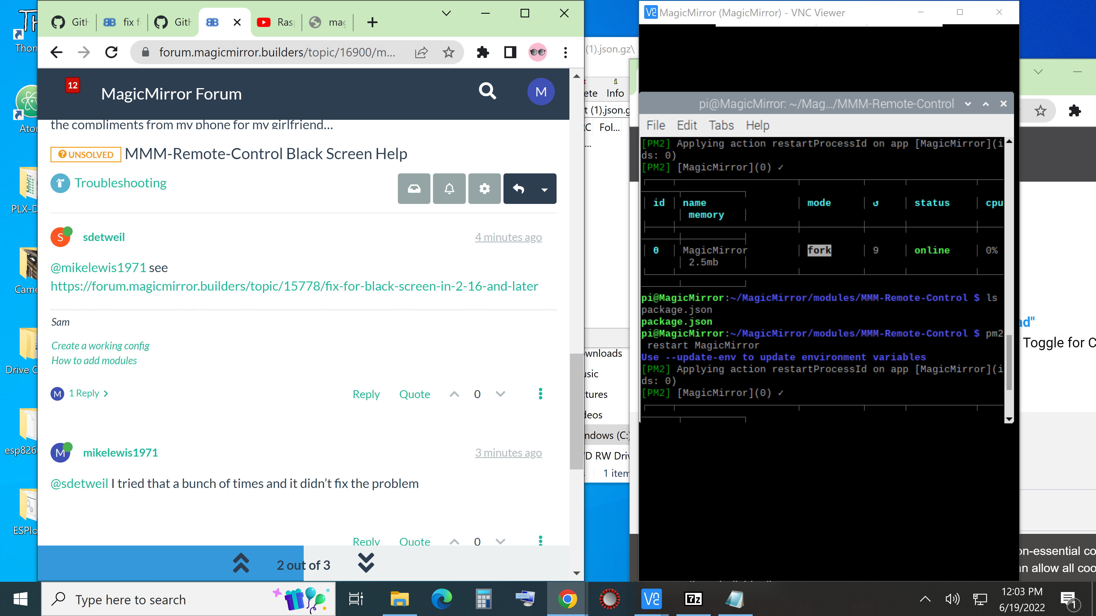

          mikelewis1971 @sdetweil
          @sdetweil I tried that a bunch of times and it didn’t fix the problem

                  sdetweil @mikelewis1971
                  @mikelewis1971 said in MMM-Remote-Control Black Screen Help:
                  MODULE_NOT_FOUND
                  same problem
                  did u do npm install in the module folder?
                  message info u need is a little further up in the pm2 output
                  pm2 logs --lines=100
                    @sdetweil Actually I just solved it by updating the installation…
                    git pull && npm install --only=prod --omit=dev
                    I had to:
                    git reset --hard
                    because I had made changes to the files and didn’t know how to commit them but after I did the pull and install and then readded the line in the config file it worked perfectly! Not exactly sure what the problem was but that did the trick :)
                    S M 2 Replies Last reply Reply Quote 0
                      @mikelewis1971 what installation?
                      never change our files unless u know what you are doing… next mm update on July 1
                        mikelewis1971 @mikelewis1971
                        @mikelewis1971 LOL… I’ve no idea… I just tried to update the files and it wouldn’t let me so I did that reset…
                        I’ve no idea what it’s doing so I can’t really explain but it’s working so YAY!
                          @mikelewis1971 what folder were you in when u did the git pull?
