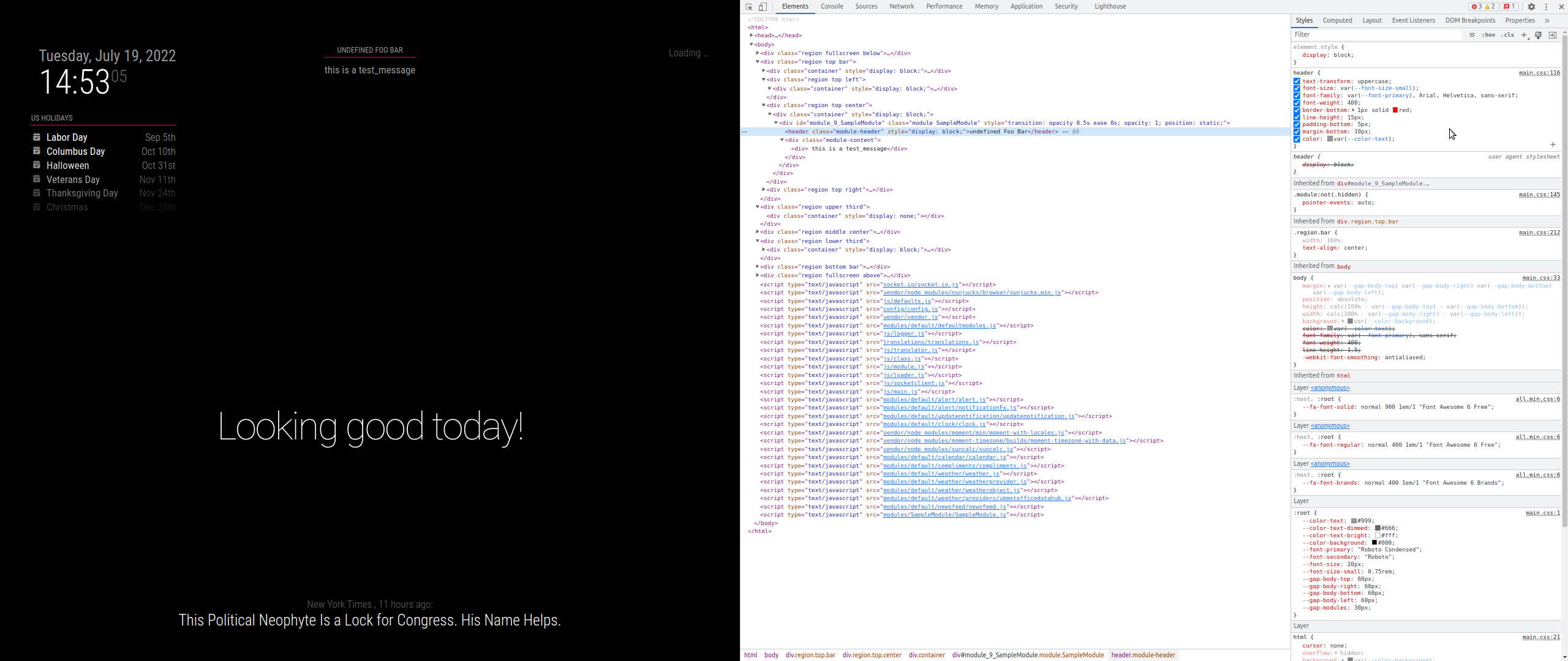

                @BKeyport eh?
                header class, border bottom
                changed to red
