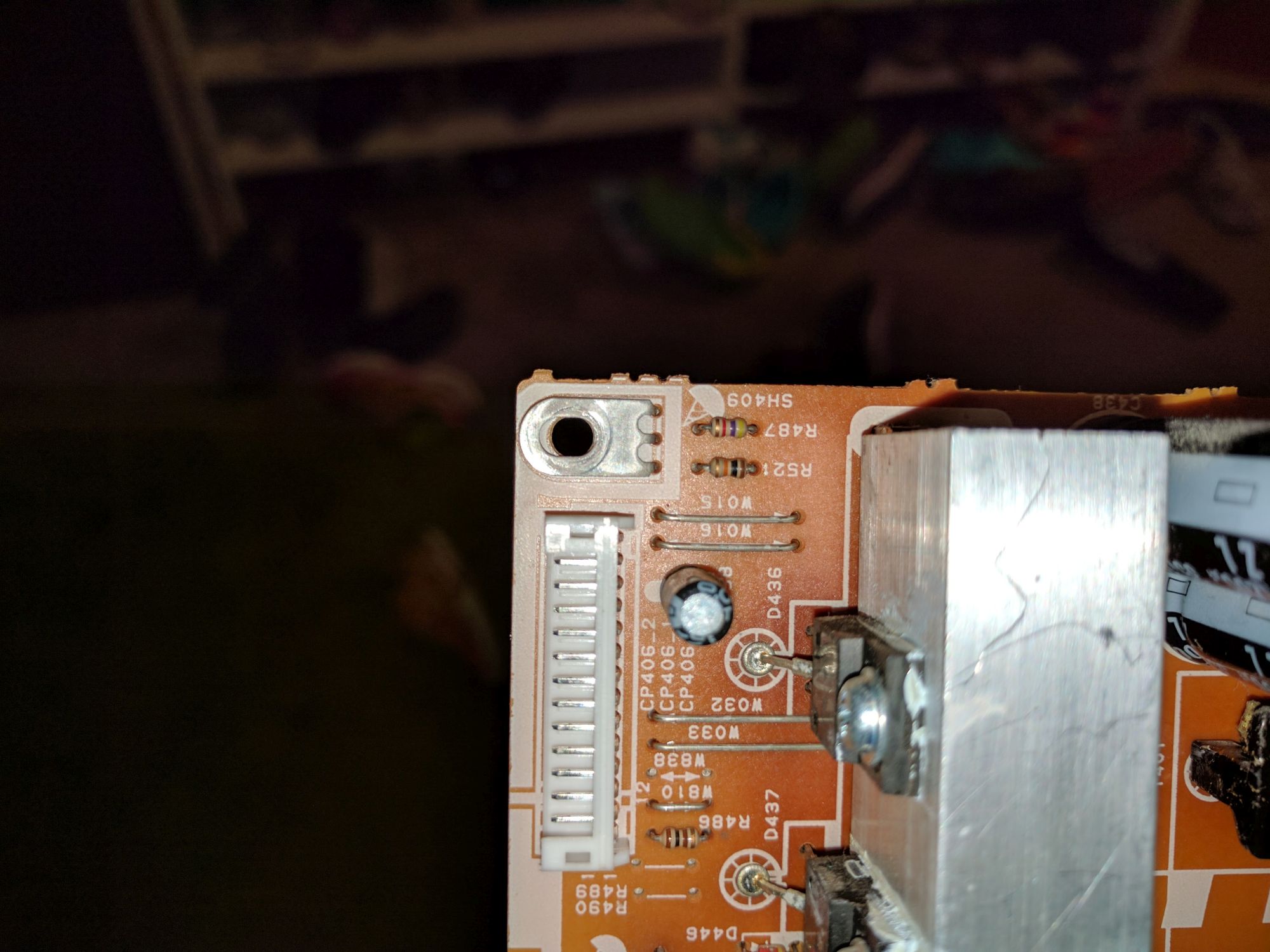

              If you look at the middle picture above, it looks like the video board and power control board (the orange one) are just sitting against the metal. Well, they were initially, but the power control board kept blowing fuses. It took me a while to figure out that some of the circuitry was probably shorting by touching that grounded metal.
              In the end, I used these to keep the circuit boards off the metal. But, now the grounding screws weren’t touching anything. To ground it, I cut short lengths of copper wire and connected them to the grounding spots on the circuit board and to the metal backing. (You can see one one the bottom left of the orange circuit board. Just to the right and below the power cord is one of those grounding wired

                  The ground connections on the circuit boards were obvious. It’s basically where the screws connect the circuit board to the metal scaffolding. Here’s a close up of the top left corner of that orange circuit board:
                  When the screw is in place, it makes contact with that bear-claw looking piece of metal. My understanding is that the various diodes, capacitors, and whatnots ground themselves through that. So, when I used those little plastic standoffs and the screws couldn’t reach, I used the wire to make the connections. If you can find long thin screws, they may work, too. I didn’t ground every one of the screw connections, just as many as I could. Seems to be enough.
                  The standoffs I bought were easy and built for this purpose. They have adhesive on the bottom, so they stick to the metal backing. Make sure whatever you use is non conductive.
                  I had to use wire to ground the orange power control board and the large green boards on the right (2 boards, but they’re connected).
                  The little board at the bottom is exactly as it was when I opened it up. If you zoom, you’ll see that the grounding screws in each corner connect to a little hill on the metal backing. That way it grounds, but keeps the circuits from shorting on the metal.
                  The board on the left controls the light panel. That one is also left as it was also.
                  Basically, if you remove enough of the metal scaffolding, you’ll need to make sure you: 1) keep the underside of the boards from touching metal, and 2) ground the boards somehow
