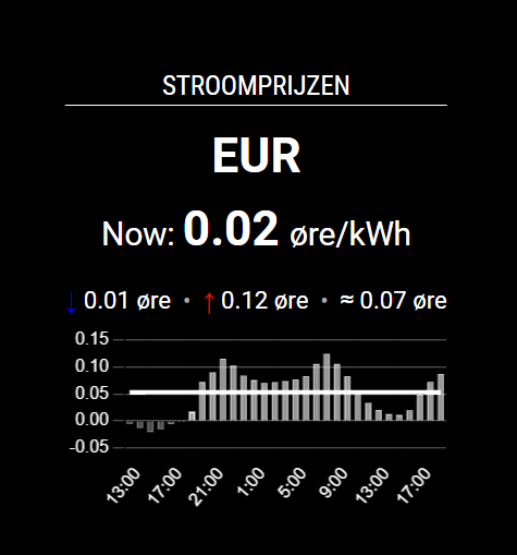

                @late4marshmellow I’d like to make use of this nice module, but i’d like to get rid of the Header part (Where it shows the words: “Electricity Price EUR” and possibly also the “Now: … ore/kWh” part.
                Is this possible with a css or maybe better with a parameter setting?

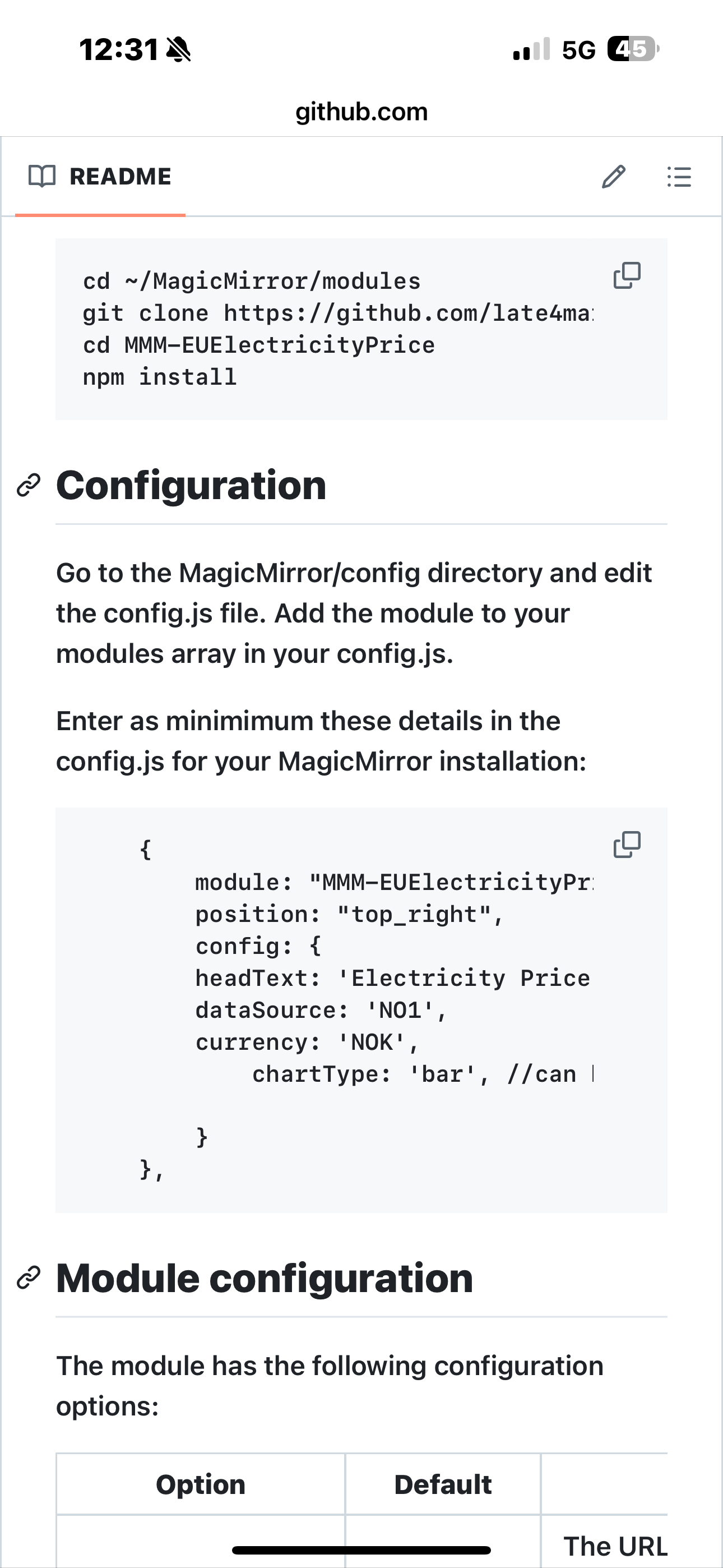

                  sdetweil @stephanvdplas
                  @stephanvdplas note the readme shows an undocumented config option
                  headText

                    This makes the “Electricity price” part vanish, but not the rest:
                    So it doesn’t help me.
                      @stephanvdplas you could use the developers window elements tab to discover css
                      see second link in my signature below
