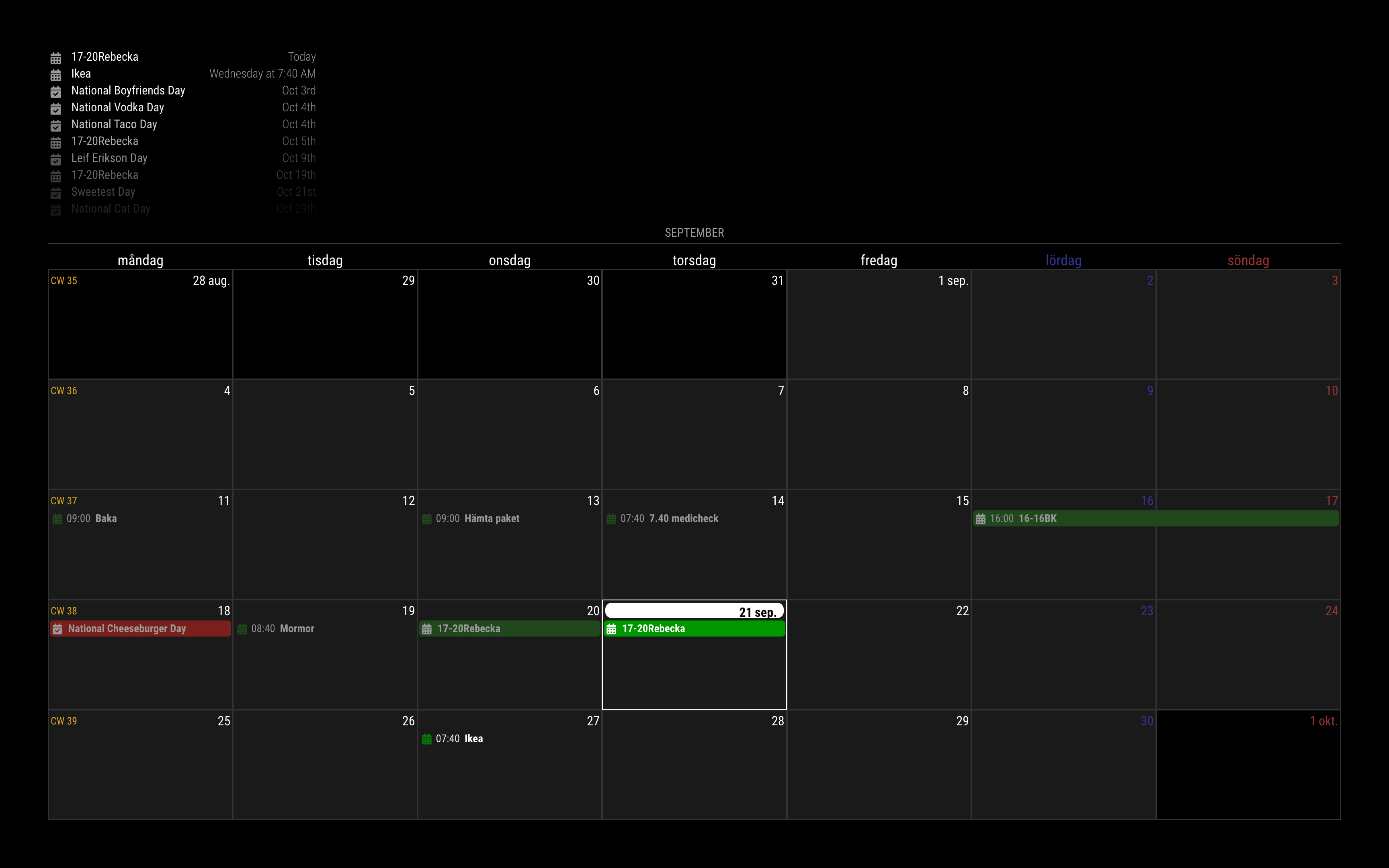

      But your picture above post shows you have Google Calendar. Could you send me the real URLs of icals? eouia0819@gmail.com
      To represent your symptom, I need real data.

          I tested URL you sent me. (Green is that one. I hope this will not be too privacy things.)
            module: "MMM-CalendarExt3",
              mode: 'month',
              locale: 'sv-SE',
              broadcastPastEvents: true,
                  symbol: "calendar-check",
                  url: "https://ics.calendarlabs.com/709/45a0bb64/Fun_Holidays.ics",
                  color: "red",
                  url: "https://calendar.google.com/calendar/ical/7a9...4/basic.ics", // <- Your real iCAL URL
                  color: "green",

            Manino @MMRIZE
            @MMRIZE No pivacy things, its ok thank you.
            Glad to see it works for you, in that way there is’nt anything wrong with my google calendar. I appreciate you took your time and look it up!
            I did copy paste your config into mine and sorry to say but it did’nt work. Then i get back to my own config again but that does’nt work either.
            You can see I get the calendar into the default one. But the month is all empty. And I have to choose “lower_third” becuase on “bottom_bar” september is drowning, I can hardly see it then. Something is really wrong. Maybe I have to start from the beginning again. I mean, it works for you so something is really wrong over here.
