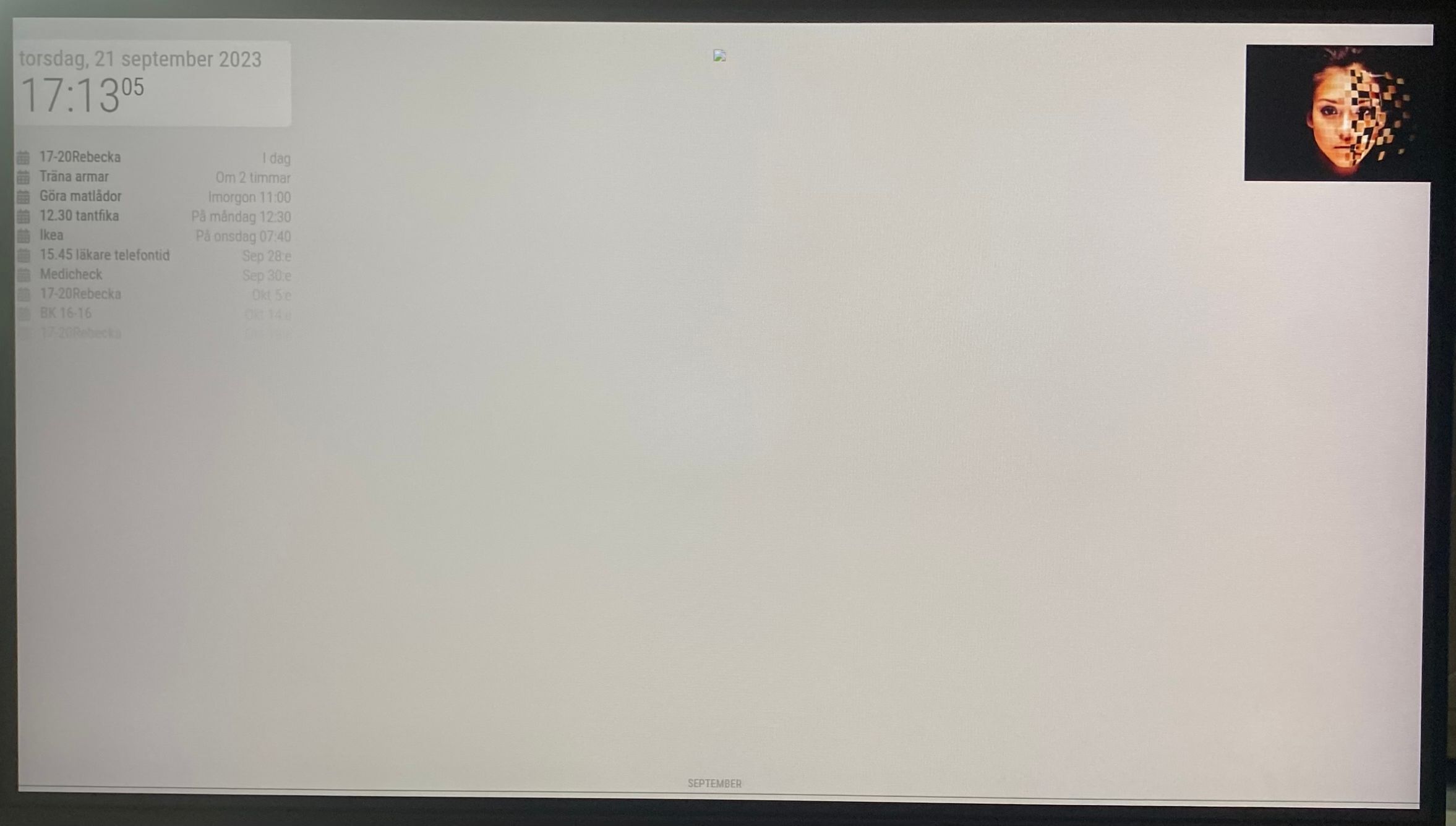

        Glad to see it works for you, in that way there is’nt anything wrong with my google calendar. I appreciate you took your time and look it up!
        I did copy paste your config into mine and sorry to say but it did’nt work. Then i get back to my own config again but that does’nt work either.
        You can see I get the calendar into the default one. But the month is all empty. And I have to choose “lower_third” becuase on “bottom_bar” september is drowning, I can hardly see it then. Something is really wrong. Maybe I have to start from the beginning again. I mean, it works for you so something is really wrong over here.
