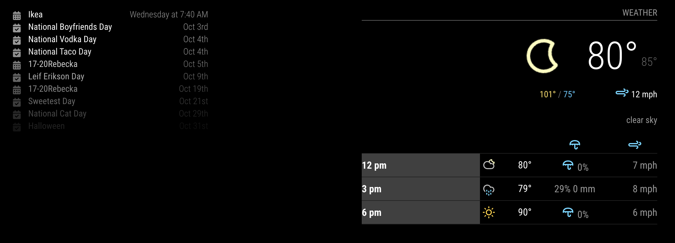

                MMRIZE @sdetweil
                I haven’t examined the rendered HTML yet, but hardcoded style attributes in HTML code are prior than CSS.
                In case; You should modify source code of the module to change the result. (Or consider to use monkey-patch)
                  MMRIZE @MMRIZE
                  @jimmy_382837
                  @MMRIZE said in Adjust individual table column widths?:
                  The rendered result is not hard-coded, so you can adjust it with only CSS.
                  This is an example. (Anyway, your config was not exactly matched with your previous screenshot…)
                  .MMM-OpenWeatherMapForecast .module-content {
                    width: inherit;
                    /* I don't know why, but it was defined as 300px, might be an issue when you adjust the dimension. so have to reset */
                  .MMM-OpenWeatherMapForecast,
                  .MMM-OpenWeatherMapForecast .wrapper {
                    width: 500px;
                    /* give a custom width to a module */
                  .MMM-OpenWeatherMapForecast .forecast-item .time {
                    /* Some customizing for `time` cell for example.*/
                    width: 200px;
                    background-color: rgb(127 127 127/ 50%);
                    color: white;
                    font-weight: bold;
