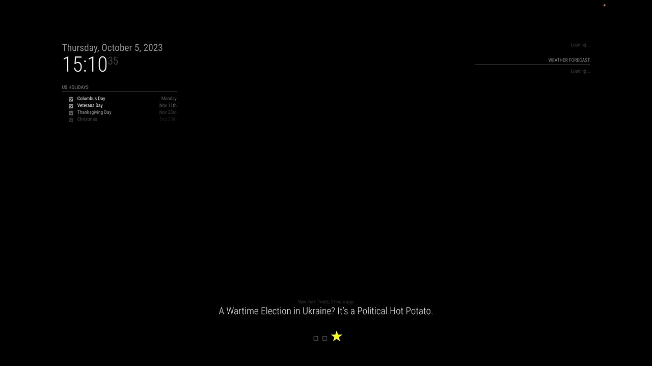

      MagicMirror module to change screen scenes by time and order with ANIMATION EFFECT.
      Demo
      MMM-Scenes2 Demo Click To Play
      Click it to see the DEMO.
