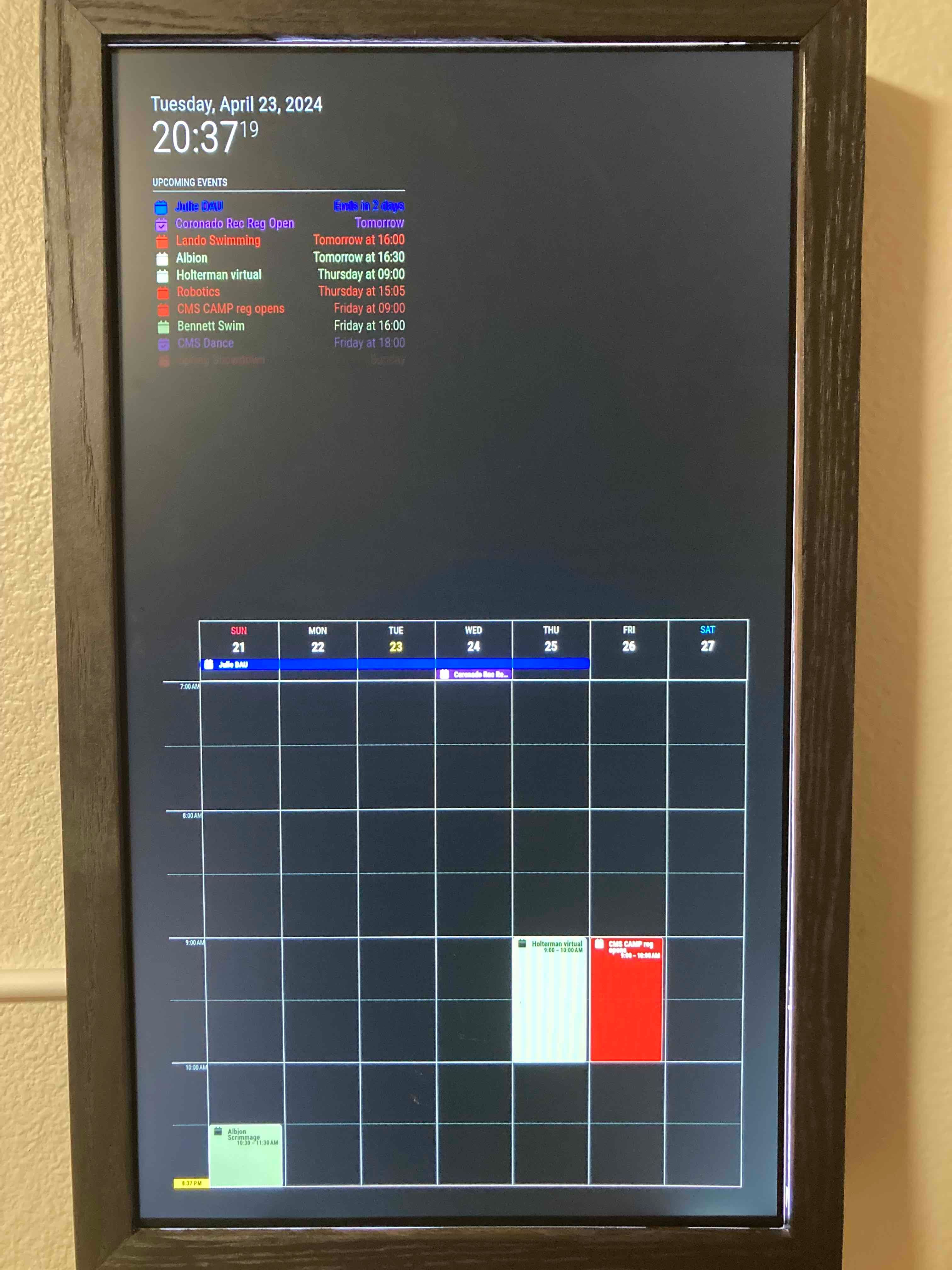

                    • J Offline
                      jlward73 @MMRIZE
                      @MMRIZE
                      I took it down to what you said and the journal displayed, but not as I expected and that may be the root of the problem. It looks like the individual calendars load up properly, but the height of each hour is too much. As a starting point, I had the calendar starting at 0700 and going for 12 hours, but (provided I uploaded the image properly), it cuts off just before 1100. I could probably experiment with the config or css file, but you would probably know right off the top of your head.
                        MMRIZE @jlward73
                        @jlward73
                        /* config/config.js */
                        	module: "MMM-CalendarExt3Journal",
                        		height: '50vh', // Half of the screen
                        		hourLength: 12, // Display 12 hours
                        		beginHour: 7, // From 7 o'clock
                        		staticWeek: true, // Since Monday
                        		days: 7, // For 7 days
                        J 1 Reply Last reply Reply Quote 0
