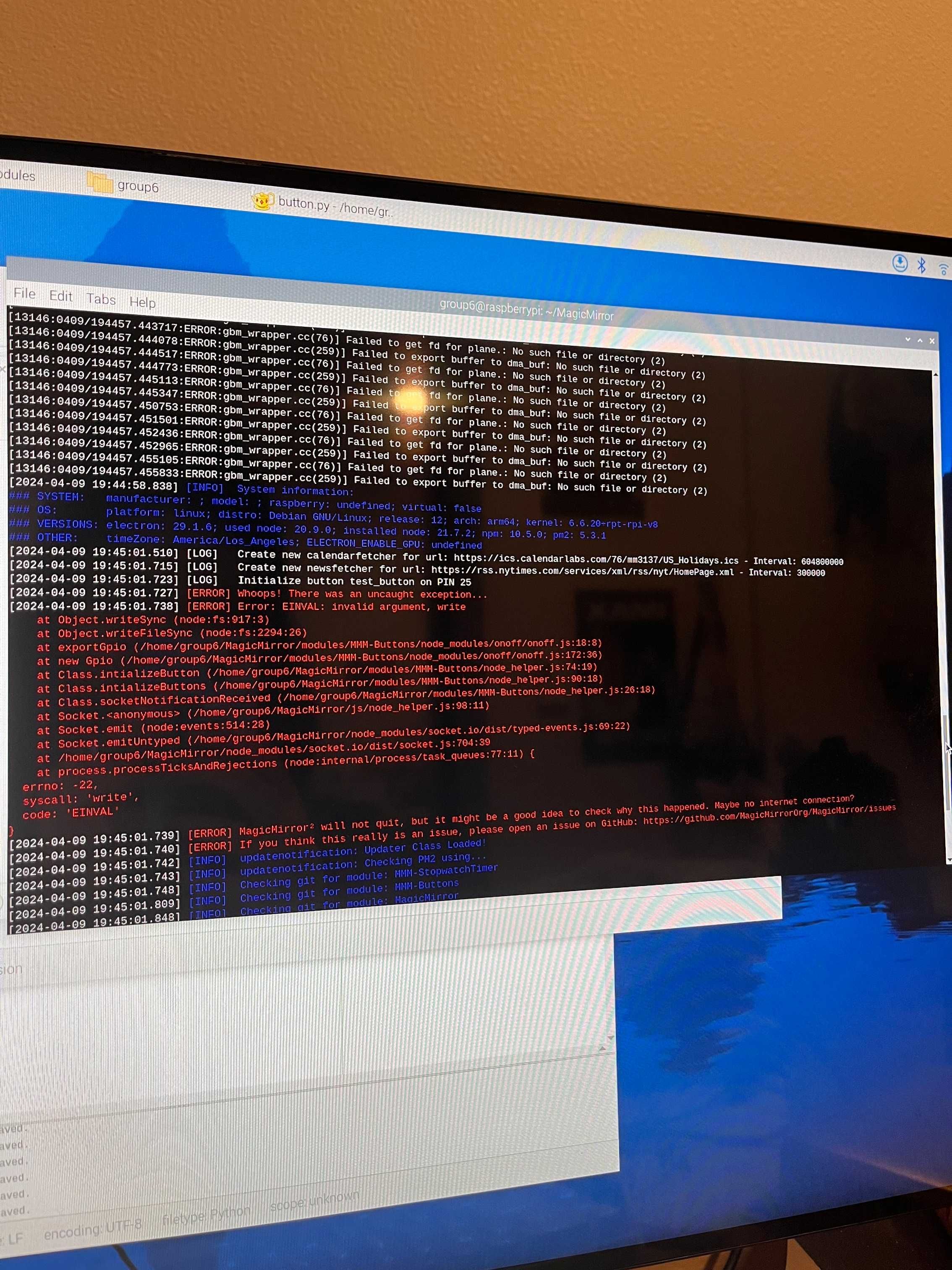

      Hello all,
      I am trying to implement a way to start a timer with an external device and am using StopwatchTimer and Buttons to do this. Recently, I kept getting this error which leads me to believe that is why my button is not working as expected.
      Thank you!
        sdetweil @changaud
        @changaud the error is that the gpio pin is in input only mode not output
          @changaud looking at the code there is a field used for a button that is not defined
          activeLow
          can you add this to your button definitions
          after pin:
          activeLow: true or false depending on how you have it wired
          if the signal is high when pressed, then false.
          if it has a pull up resistor then true, it will be pulled down when pressed
          you said your python is reporting high sll the time

            and I get this error:
            [ERROR] WARNING! Could not validate config file. Starting with default configuration. Please correct syntax errors at or above this line: /home/group6/MagicMirror/config/config.js:117
            activeLow = false,
            SyntaxError: Invalid shorthand property initializer

              sdetweil @changaud
              @changaud said in Unknown Error after initializing buttons:
              activeLow = false,
              not =
              activeLow : false

                      sdetweil @changaud
                      @changaud which same error are we talking about? the syntax error or the einval write error
