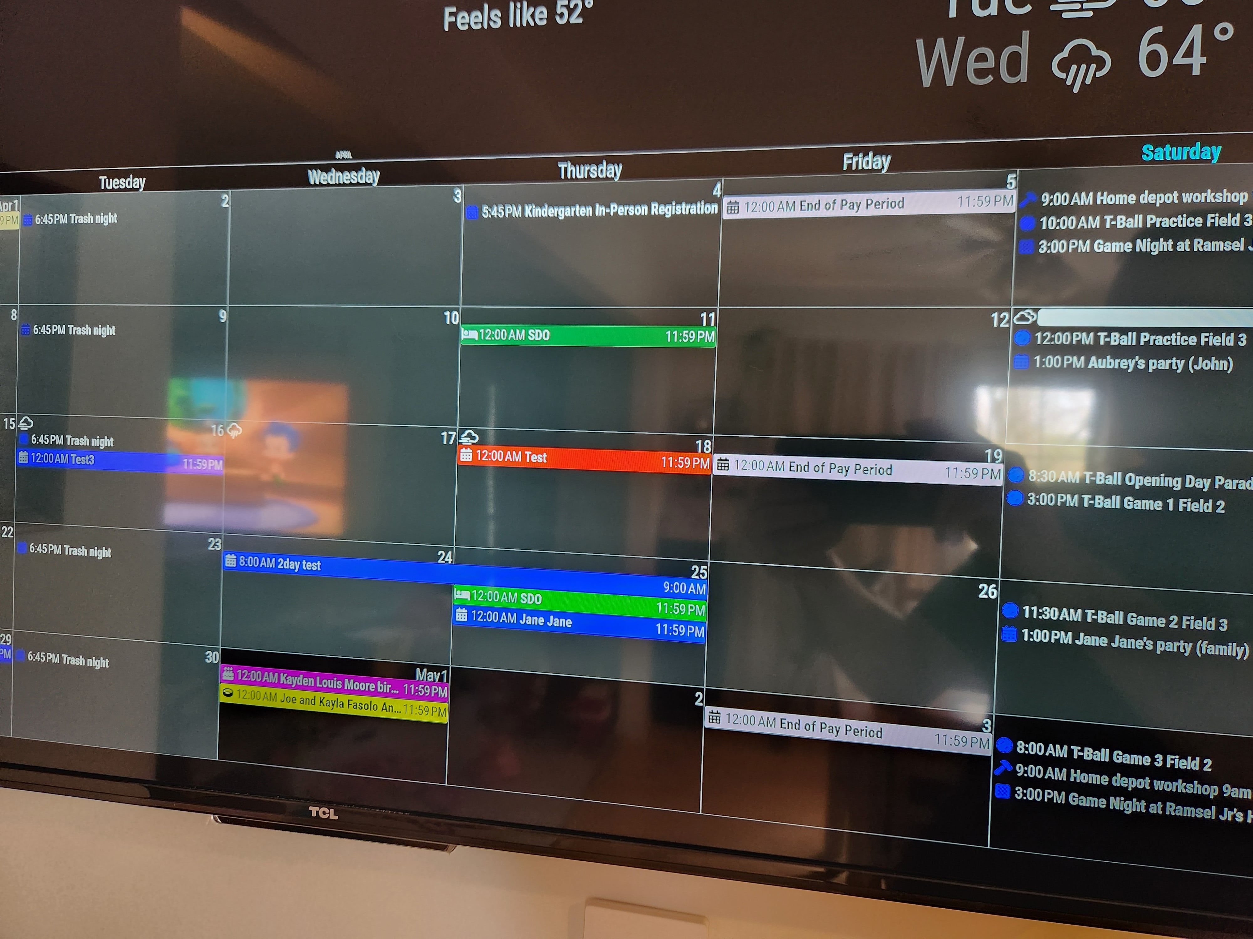

      I’m having issues with my calendar view. The closest to being correct is the first picture. Everything here is correct however 1 event is duplicated on the 2nd of each month and should not be.

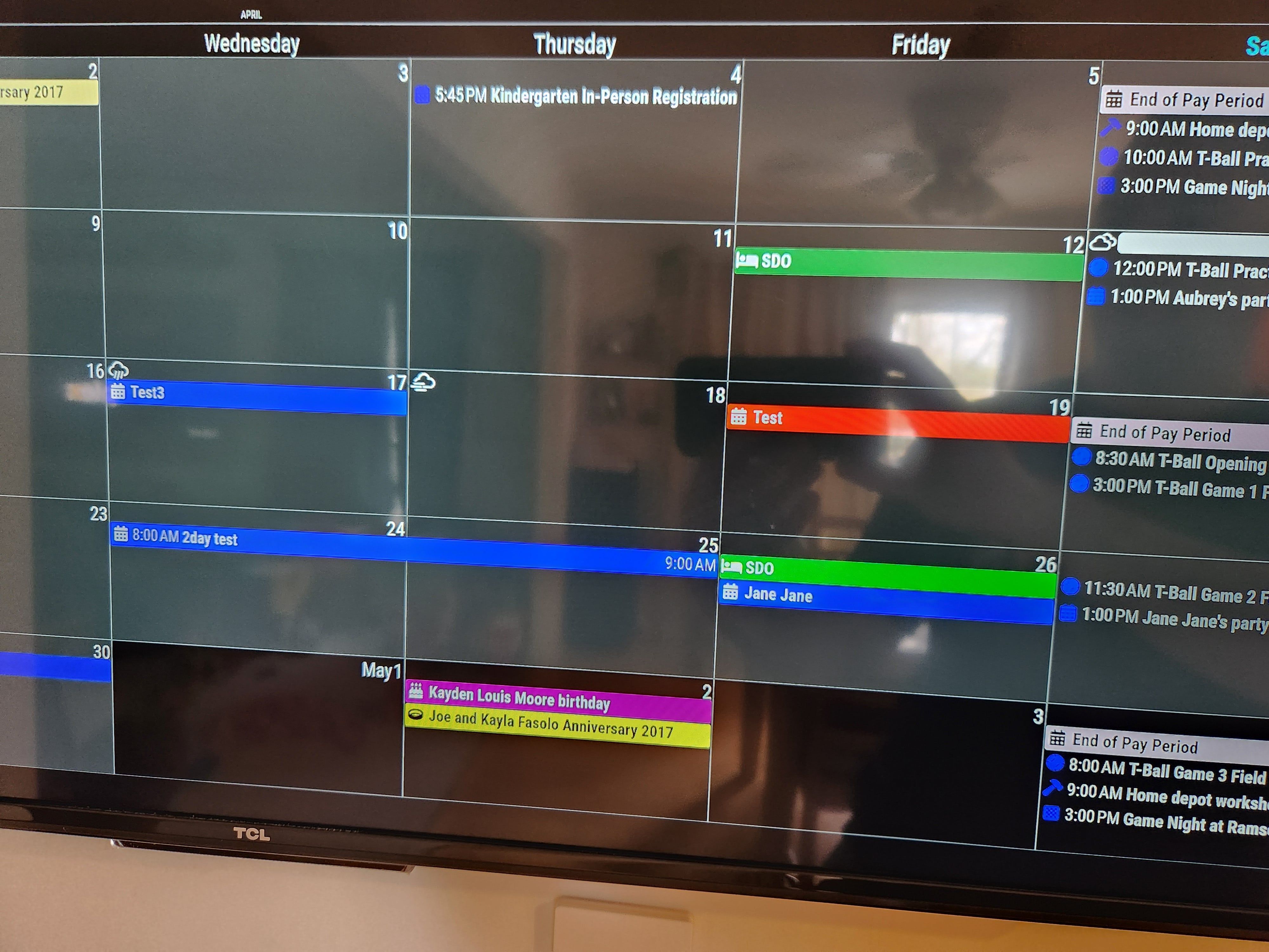

      The next image shows all of the full day evens shifted left by one day.

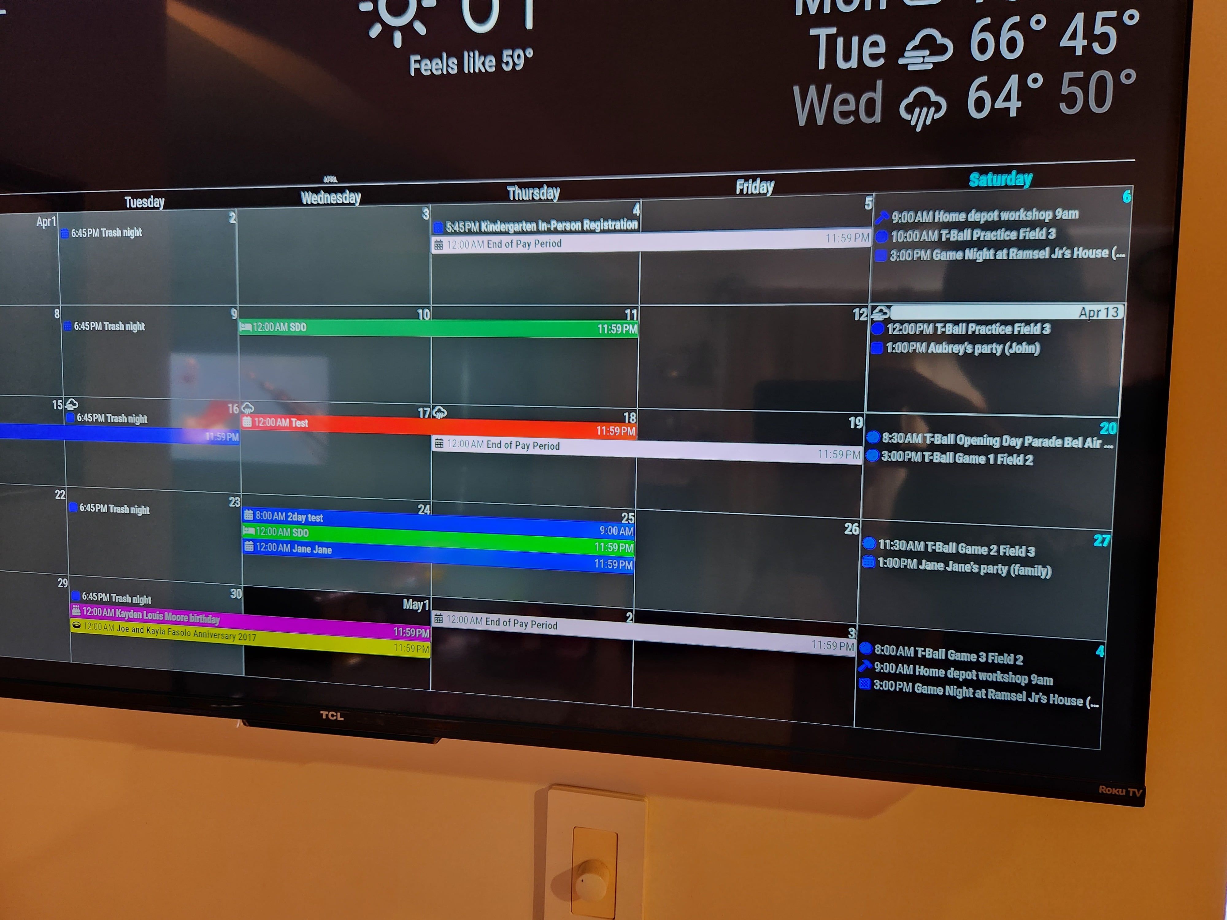

      The next shows the full day event expanding by one day the following shows the event expanding one more day.
      All of these occur with the same config file and change between them when it does it’s refresh
      Can anyone provide any insights or troubleshooting steps.

        This may be related
        https://github.com/MMRIZE/MMM-CalendarExt3/wiki/To-fix-wrong-repeated-fullday-event-displaying-(MM-2.27)
        B 1 Reply Last reply
        • B
          bramsel @MMRIZE
          @MMRIZE R
          I made the change and this morning I noticed I had the 3 day event’s again. I have not seen the 1 day shifted or 2 day events as of yet. I’ll play around with the payload and see if I can fix it. Thanks
