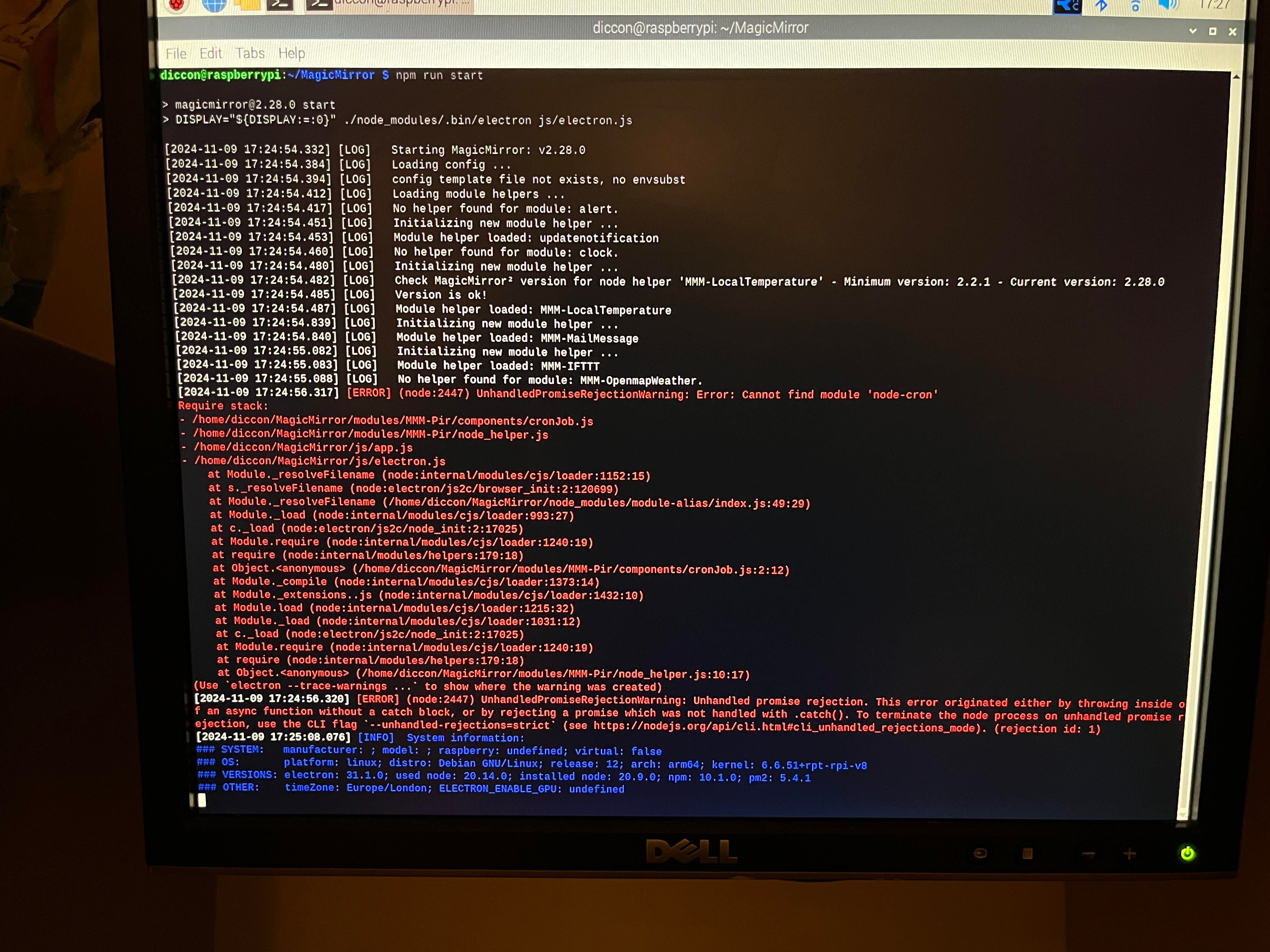

      I got the warning on my RPi about the changing x-window to Wayland. I rejected the update and now my Magic Mirror will not start. I have attached the log which appears when I try and start the mirror from a terminal window.
      Help please.

        @diccon you did not post the log
            sdetweil @diccon
            @diccon yes, a module is missing a required library , you need to run npm install in the module folder for the specific module
            this is version 2.28, latest is 2.29, we have added code to catch these failures and continue running, where before we crashed.
