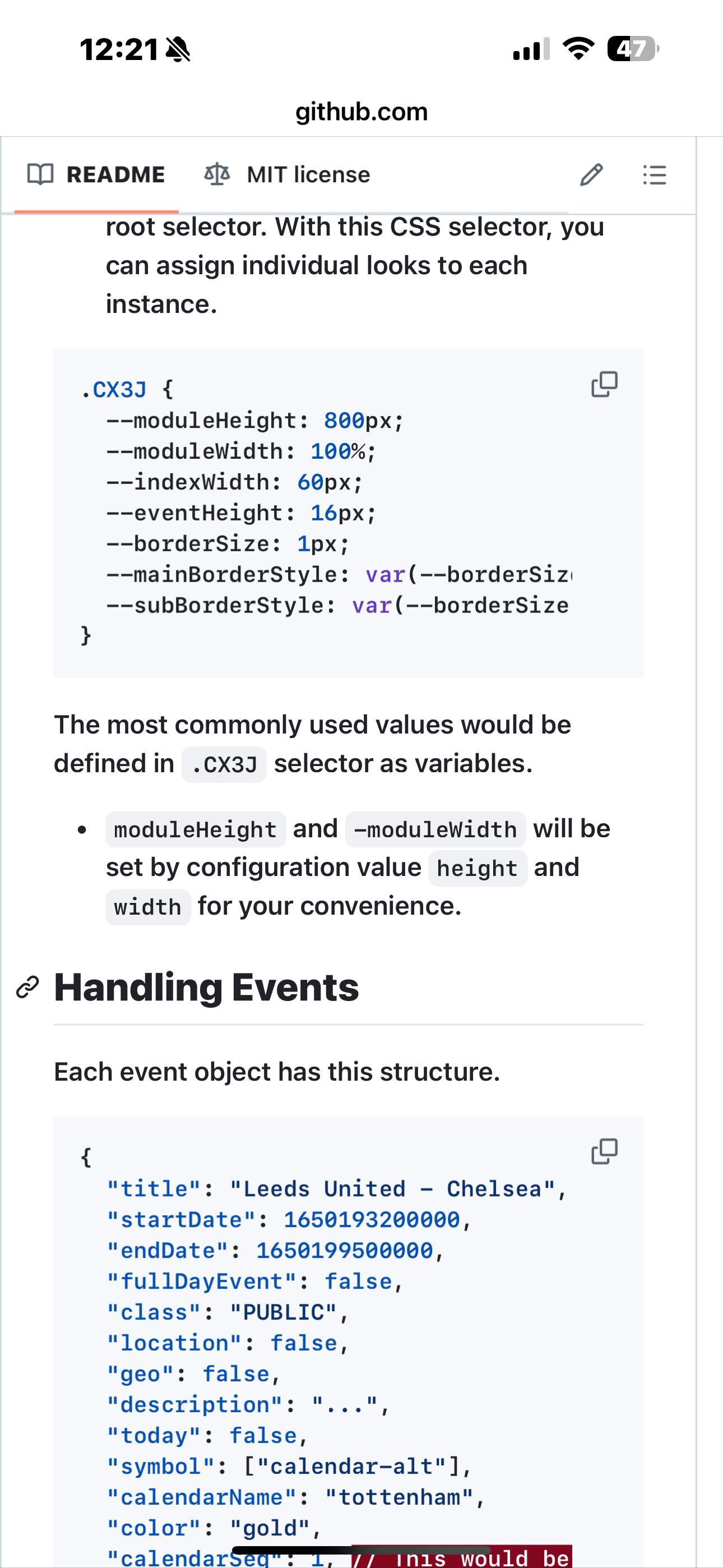

      For my Senior calendar I want to extend the Ext3Journal at position “middle_center” to use the full height.
      I found a lot of informations about margins and gaps but cannot find the way how to extend this module.
      How can this be done?

        @nobbistyles define more rows, or set the h/w

          Solved with:
          • Added 2 rows.
          • Increased hw
          • Increased region middle.center
