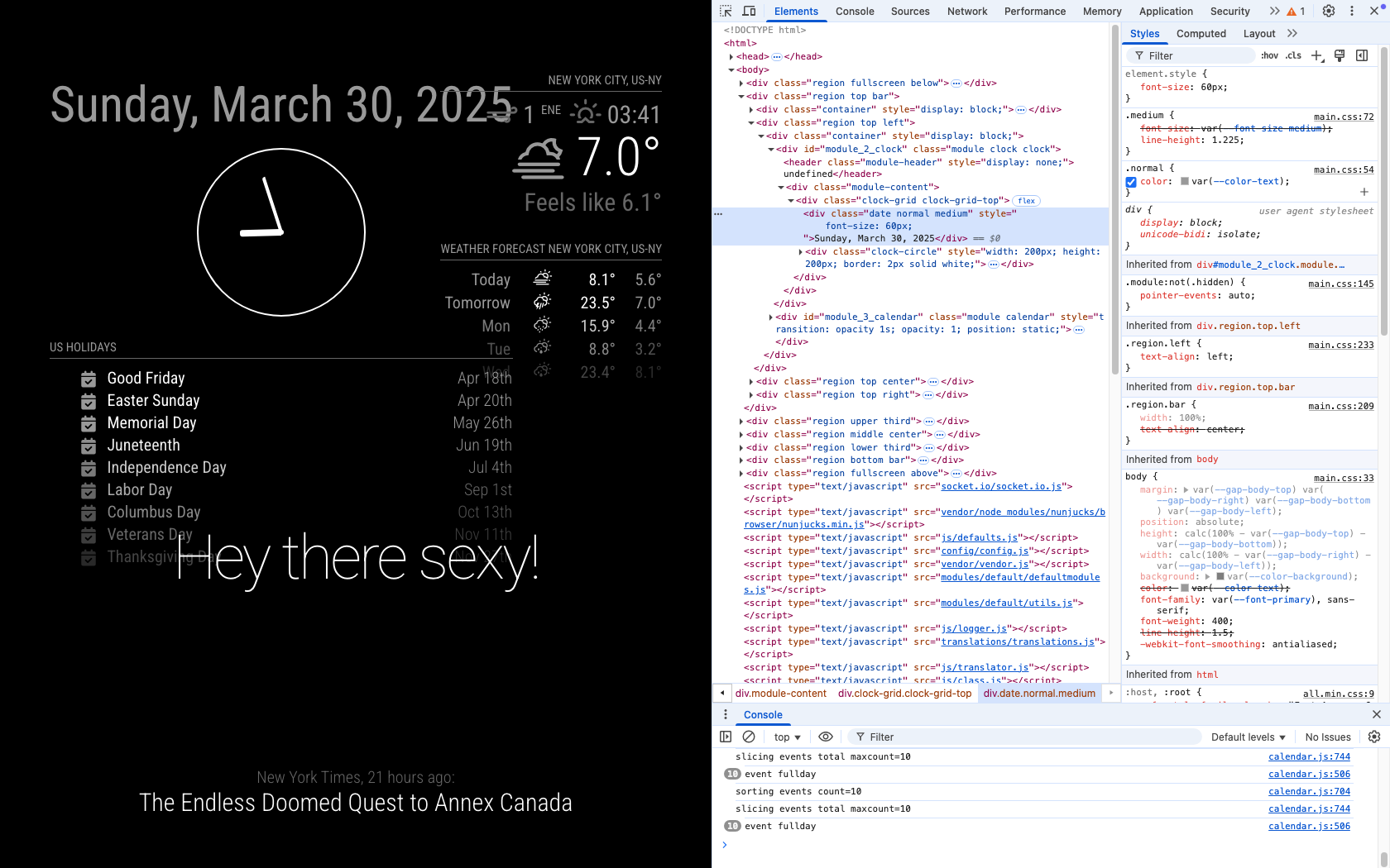

        @briantogo font-size was easy
        .clock .date {
          font-size: 60px; // or whatever
        the clock hands also easy as they are commented in clock-styles.css

          sdetweil @briantogo
          @briantogo yes, thru css. see clock_styles.css
          override that in the custom.css

                sdetweil @briantogo
                .clock .date {

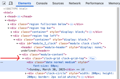

                      Hi Sam, I loaded my new RPi5 with 16 GB’s ram, and boy does it fly!
                      So getting back to issue, I tried changing the clock hands in clock_styles.css. I changed the hour hand to 2 and changed the minute hand to 20, and could not tell the difference.
                      Also, I could not change the text size of the date above the analog clock. When I use the developer mode, I cannot expand
                      When I click the drop down arrow, it briefly expands then contracts again.
                      Any suggestions please?

                        sdetweil @briantogo
                        @briantogo disable seconds for the debug then it will stay
                        you changed both values for both hands, right?
                        show your custom css for clock
