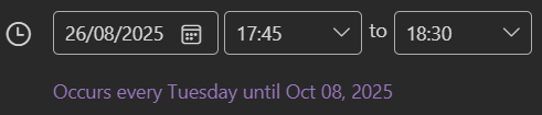

          The timezone does look to be getting updated to the IANA string. But line 33 has:
          "until": "2025-10-07T16:45:00.000Z",
          but the final event should be starting at 17:45 and ending at 18:30. So the ical does seem to imply that the series ends prior to the final event starting. Even if we account for the hour difference due to a potential timezone issue, the series is ending right as the final event starts.
          Is there a particular part of the log that might be useful for digging deeper - a search string I can use to narrow things down? Or are we just looking at another Microsoft quirk…
            sdetweil @WallysWellies
            @WallysWellies the ICS has
            RRULE:FREQ=WEEKLY;UNTIL=20251007T164500Z;INTERVAL=1;BYDAY=TU;WKST=MO
            so its a source problem. the parser processed this correctly.
            we have no idea why its set like this, we just process the ICS data.
            but the until is weird
            Until Oct 08 (in the UI) , which isn’t a Tuesday, so the event could not happen then anyhow.
            I’d try changing that and see what happens with the ICS data
