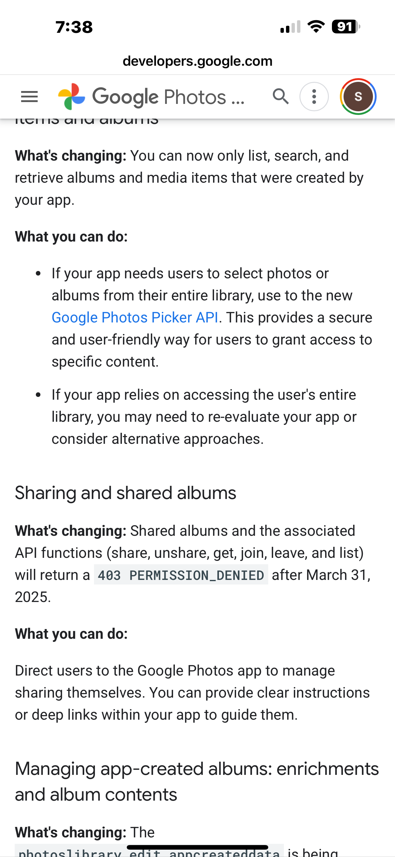

        sdetweil @Jabl0
        @Jabl0 error 403 is forbidden
        google has announced a change in behavior for the google photos service. they haven’t clearly said when it would take effect
        see
        https://forum.magicmirror.builders/topic/19460/google-photos-api-changing-mmm-googlephotos-will-stop-working-soon.
        https://developers.google.com/photos/support/updates

          @sdetweil said in MMM-GooglePhotos suddenly stopped working this morning:
          @sdetweil thanks for the reference, i will look at MMM-ImagesPhotos as an alternative and see if it fits my use case.

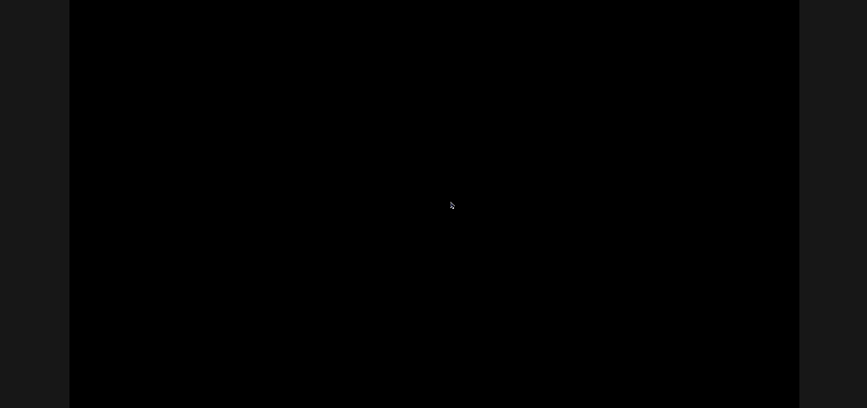

                        One thing i have noticed this module doing that the MMM-GooglePhotos module did not do, is it just goes black with only the mouse curser showing. Nothing shows up in PM2 logs when this happens. I guess its because it runs from browser?
                        Anyway i can troubleshoot this and see what is causing it? Maybe my Pi is not powerful enough? Its a Raspberry Pi 3 Model B.
                        See screenshot below:
                        Thanks :)
